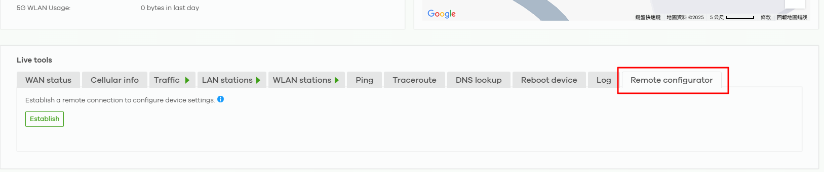

    Hi @ChrisMace
    If your FWA505 is online on Nebula, and you want to access its device's web GUI, you may use the remote configurator - a live tool function - to access.
    And you will need to use Nebula site-wide password to login.
