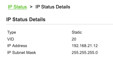

The switch's IP status page shows:

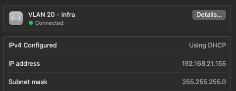

If I connect my Mac to port 15 (vlan 20, tag only), using a virtual interface with VLAN 20, I get assigned an address from DHCP:
From now, I can ping other devices on the same VLAN/subnet. I can also establish TCP-based sessions (e.g) SSH out to internet hosts without issue.
