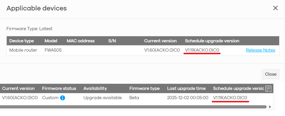

Today on NEBULA console are FW update available for FWA505. Technical information looks like downgrade are pushed out: from V1.60(ACKO.0)C0 to V1.19(ACKO.0)C0 Are this right or this is wrong technical information and routers get only patch for recently exposed problem discussed in other community posts?

    Hi @Dainis_LV
    This is because we removed the firmware V1.60(ACKO.0)C0 since this firmware has an issue on the remote configurator.
    We have uploaded the new firmware V1.60(ACKO.2)C0. The upgrade schedule should be updated/corrected.

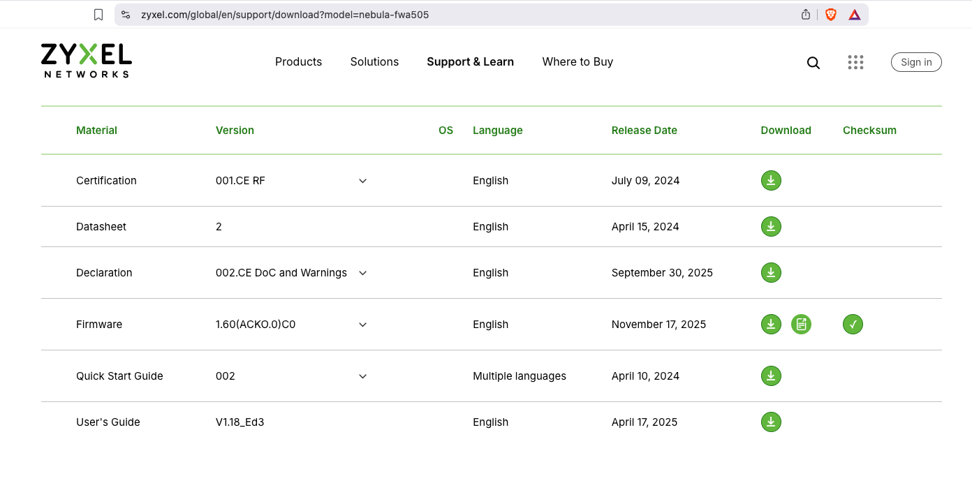

    Hello @Zyxel_Melen , the download page still shows version V1.60(ACKO.0)C0.
    Thank you.

    Hi @Daniel_505
    Please allow me to correct my previous comment. The firmware V1.60(ACKO.2)C0 is uploaded to Nebula first. You may upgrade on Nebula by the function Menu > Site-wide > configure > firmware management > Overview > Mobile router part to upgrade. You need to select the firmware type to latest. This can ensure you upgrade to V1.60(ACKO.2)C0 which the is latest version.
    The Zyxel download library still shows the old version because the internal process is still running. Please be assured, this will be updated soon.
