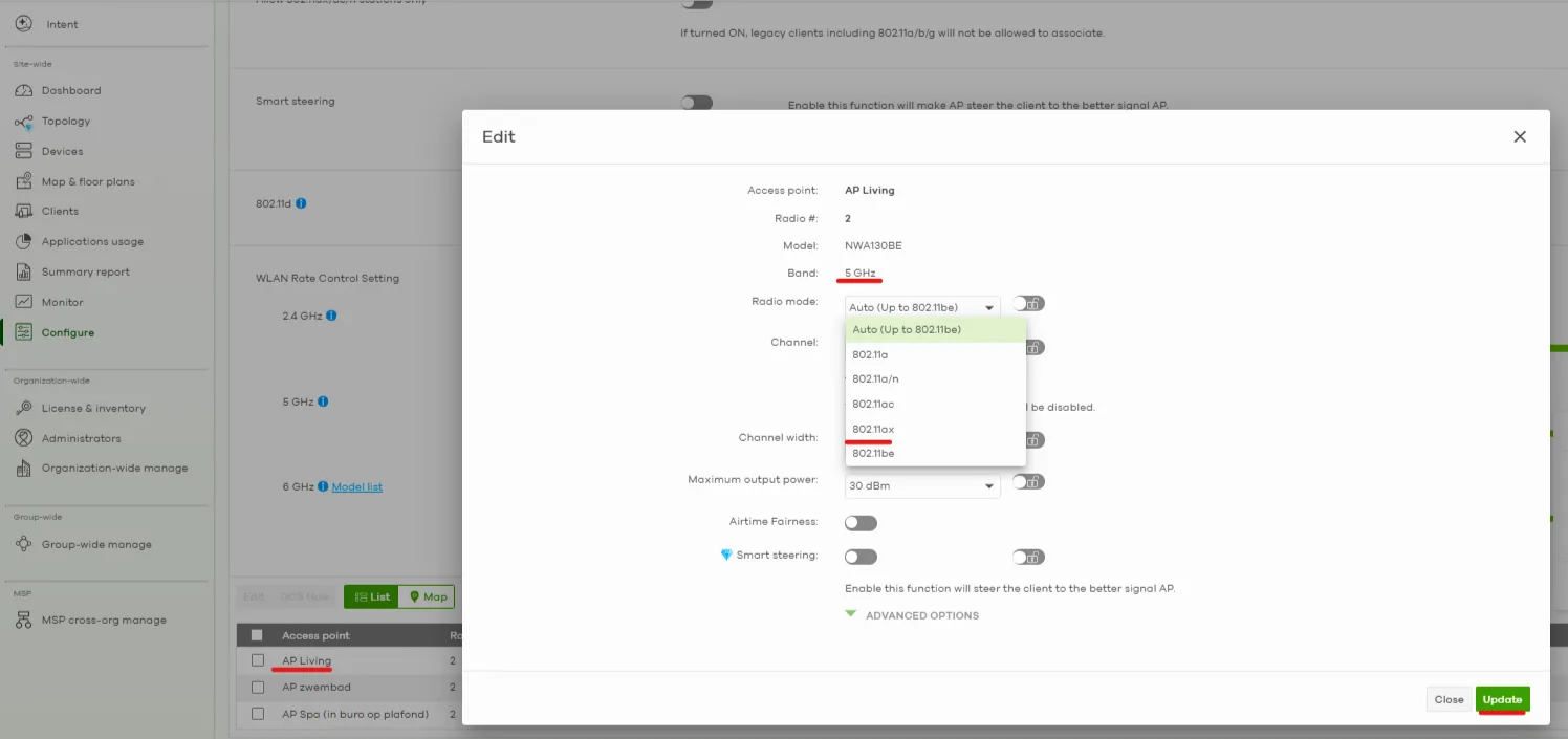

    After reviewing the logs, we suggest enabling 802.11ax mode on both 5 GHz and 6 GHz under the radio settings and staying closer to the AP to see if the connection improves. (The logs from your screenshot show low signal strength, sometimes from -79dBm to -87dBm, which may be affecting stability.)
    Here is an example:

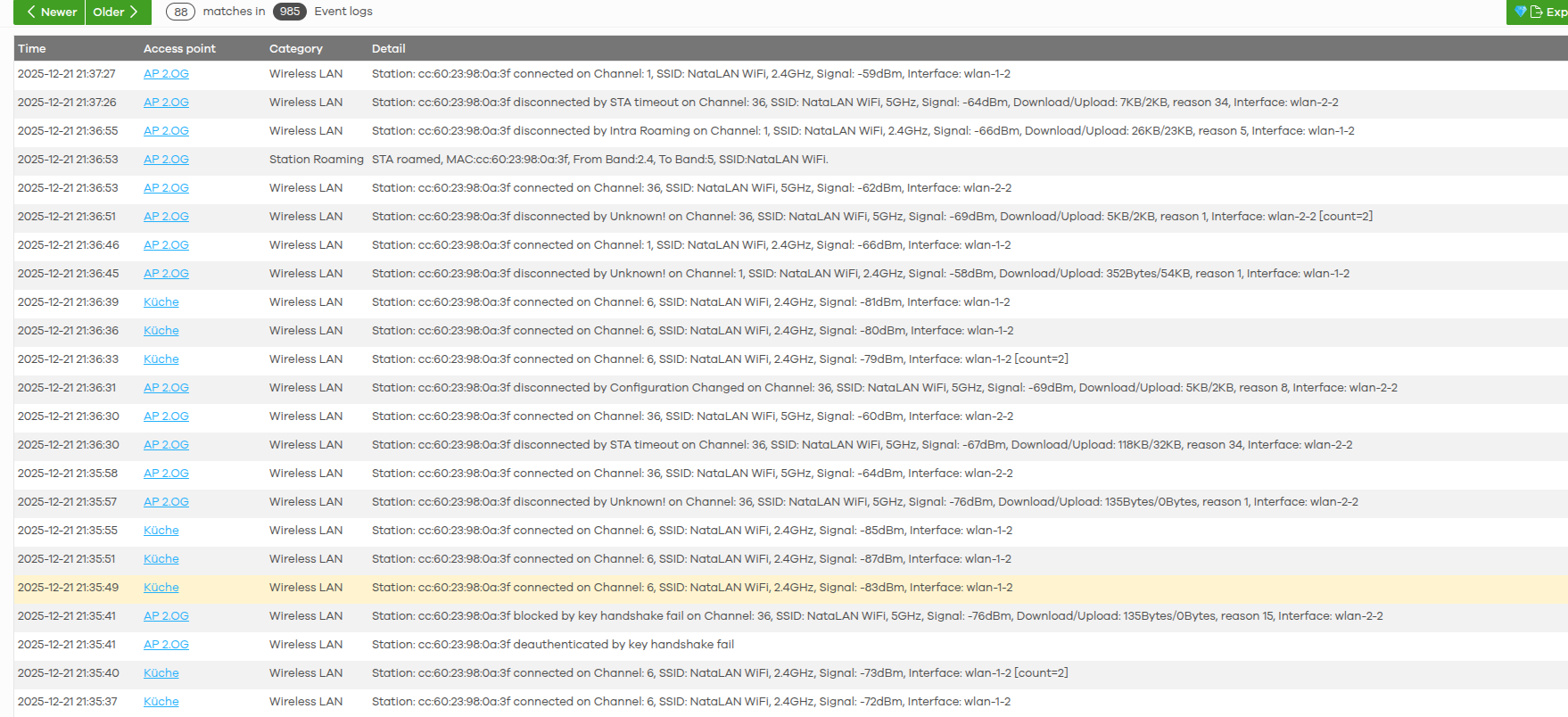

    Attached is a screenshot from an affected iPhone.
    Here is an example:
