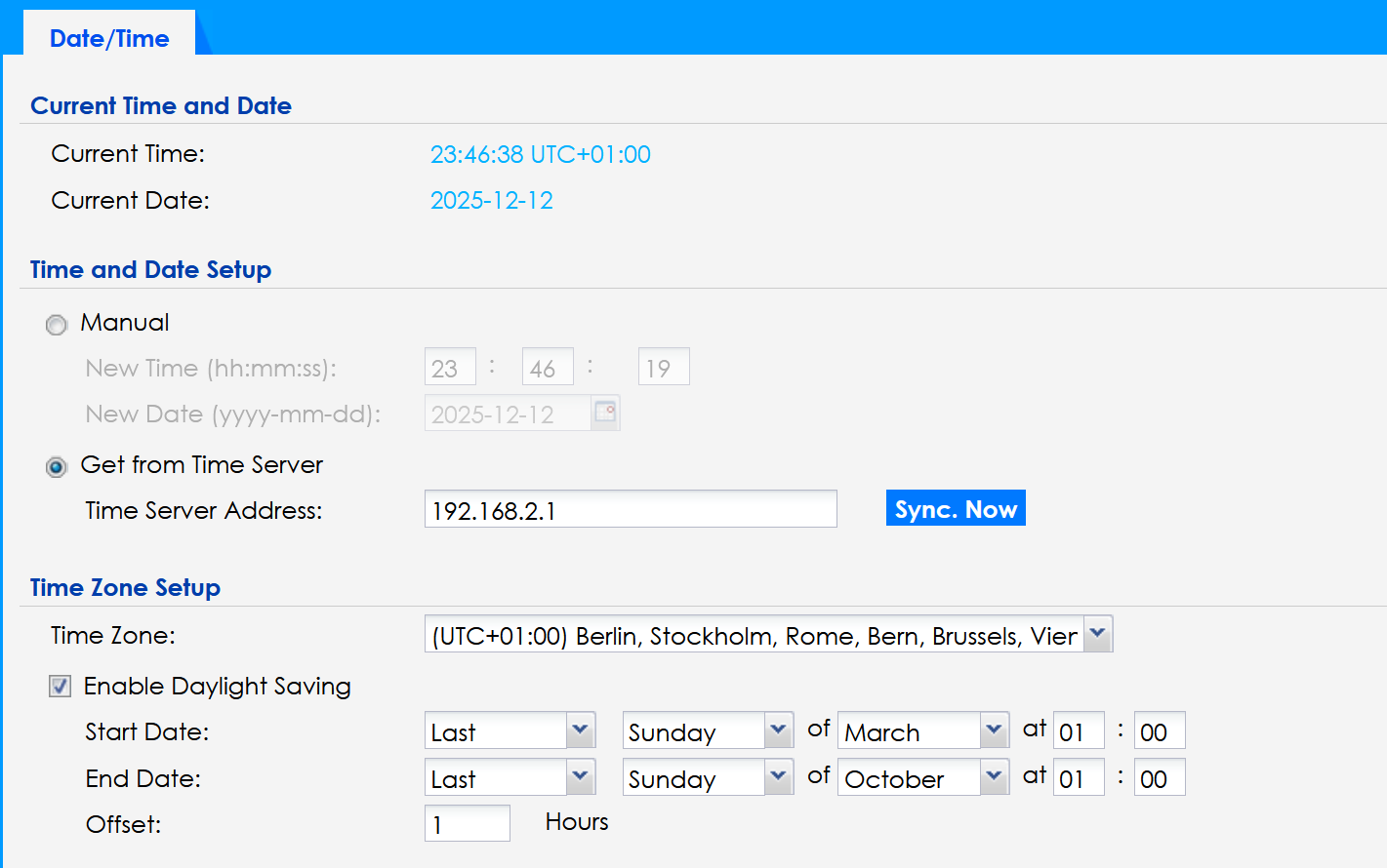

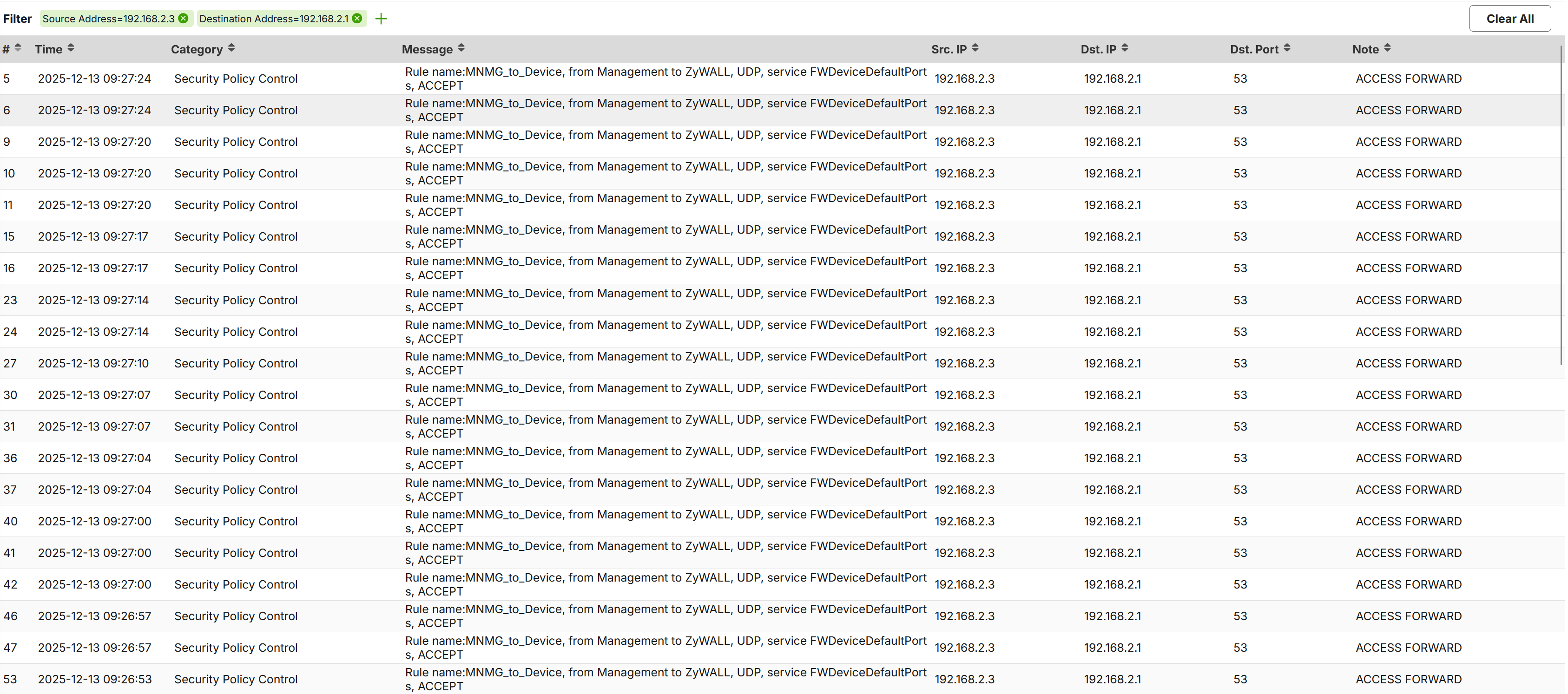

I've the firewall USG Flex 200HP and I've configured it as a personal NTP Server, but seems that the AP (192.168.2.3) is not contacting it.
Seems that the AP is contacting the firewall (192.168.2.1) only for DNS requests.

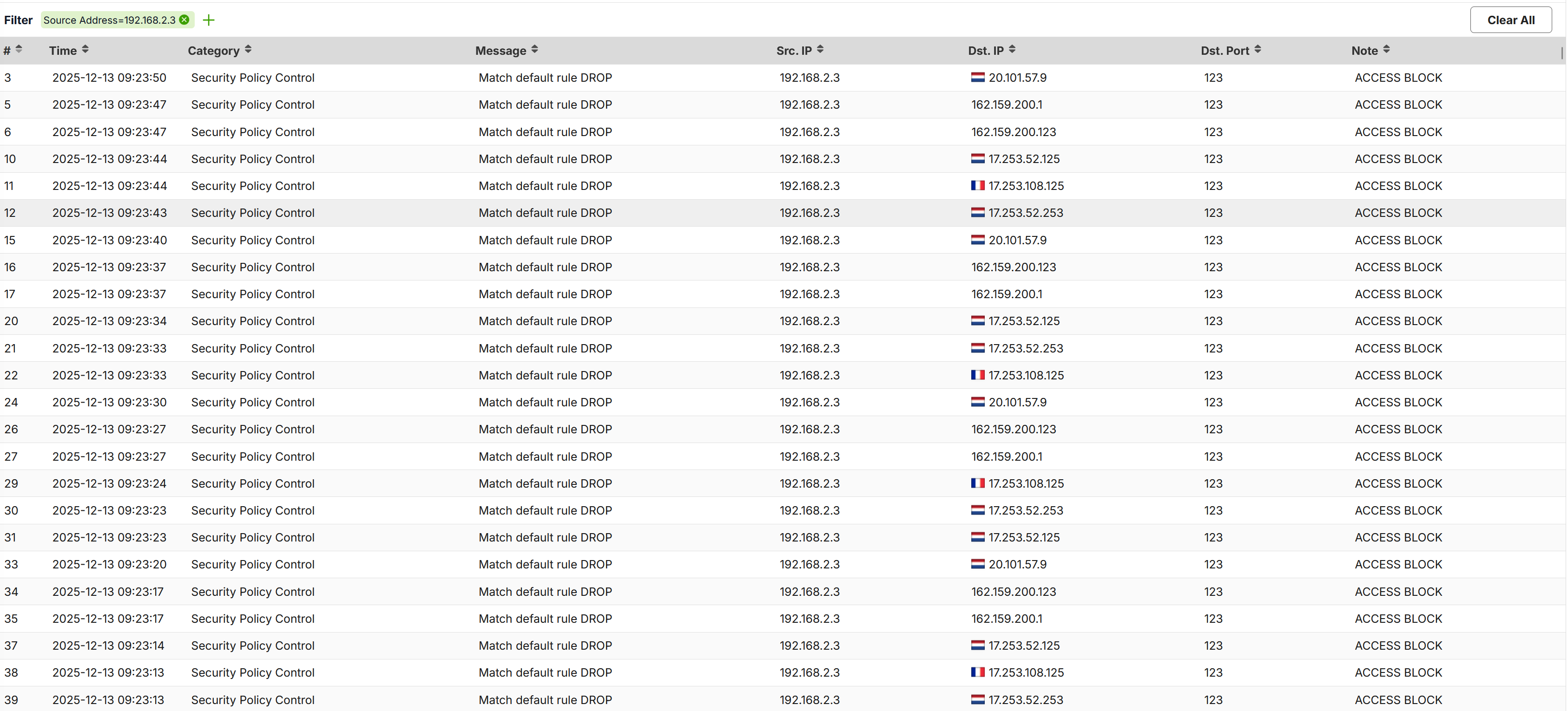

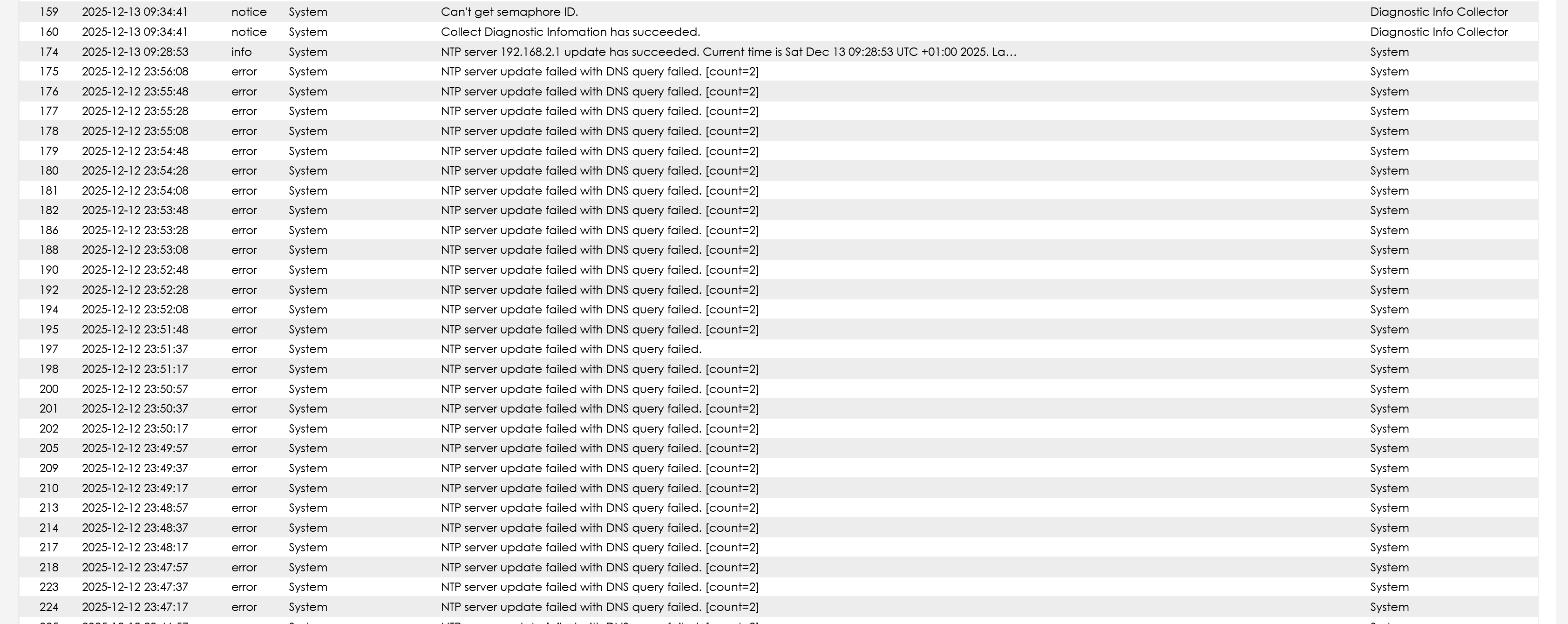

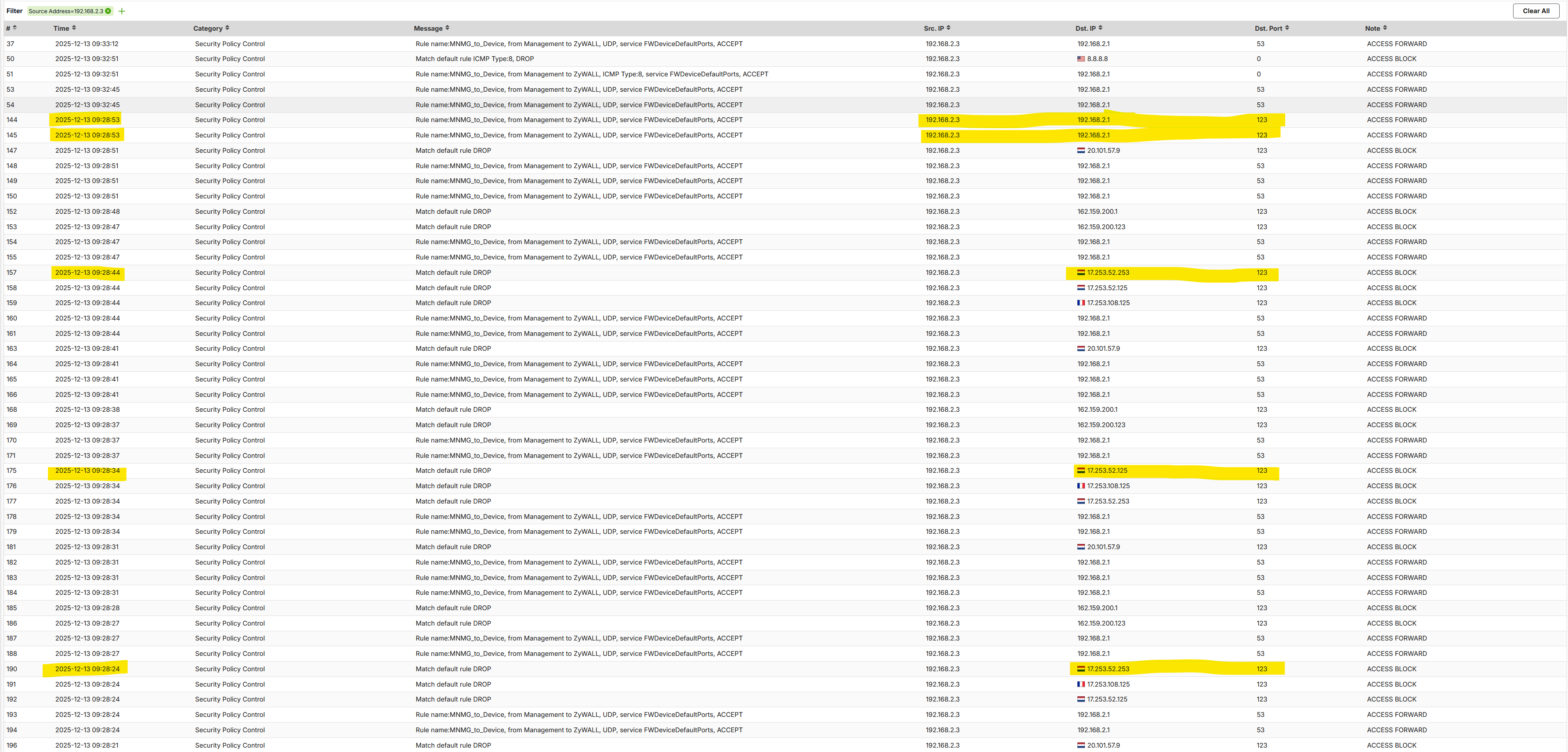

After push the button "Sync now", the AP is sync with Firewall's NTP and seems that the requests on DNS and external NTP Server is not arriving anymore on the firewall with elevated frequency (only when necessary):
As for connection logs, seems that the AP try to reach another NTP Server (why?!? what is the NTP Server that try to contact??) every 10 seconds, and after the connection was successfully on the FW NTP Server, the situation was normalized.
Why the AP try to ask the date/time to other NTP Server and not retry to the Time Server Address specified?

    Hi @Maverick87,
    After discussion, we confirm that the issue stems from a timing gap during boot-up. The AP attempts to sync with the manually configured NTP server before the firewall's NTP service is fully ready. When this initial attempt fails, the current firmware behavior switches the AP to a list of built-in backup NTP servers for polling.
    We recognize that this behavior can be improved. Therefore, we will mark this as a feature request to implement a spec change: the manually configured NTP server will be included in the polling list, ensuring the AP eventually returns to your designated internal server once it becomes available. We will keep the community updated on the planned firmware release that includes this improvement.
