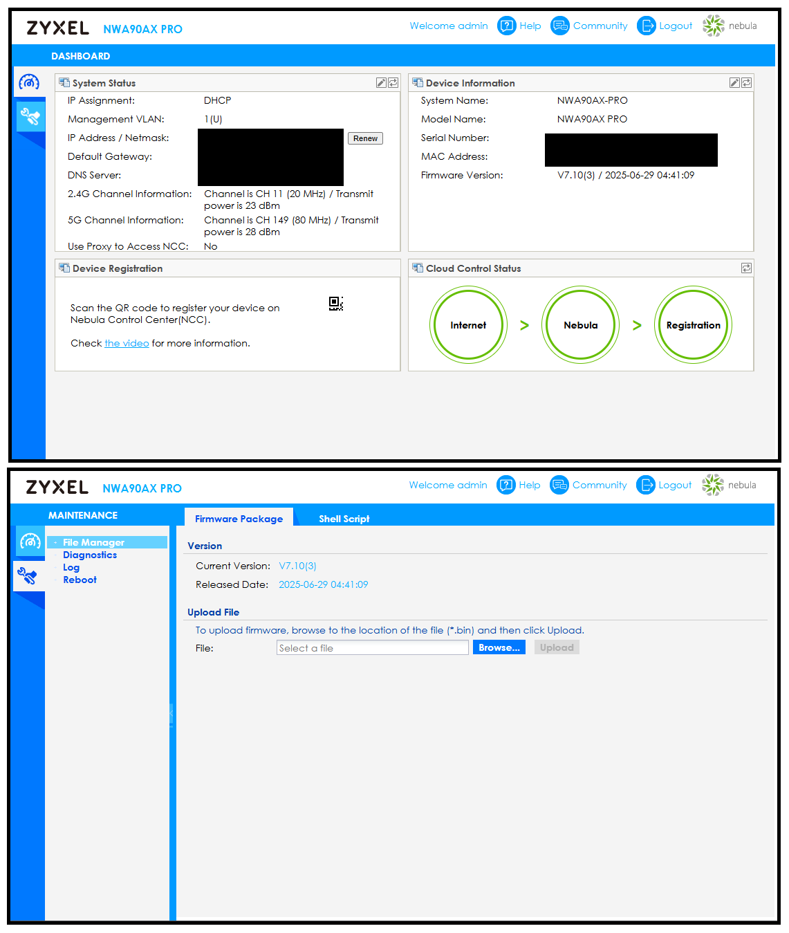

I have a NWA90AX-PRO AP and I do NOT want to set up a Nebula account just to configure the thing. I only have 1 AP and have absolutely no need or desire to "centrally" configure it. That would make sense if I was a business managing multiple APs across many locations, but for a simple, single home AP, there's absolutely no need for it.
I bought the AP new off of Amazon (seller was listed as Zyxel).
The user guide says that when I login to the AP, it should immediately open the configuration wizard, but that does NOT happen. Instead, the initial dashboard shows that the AP is already registered in Nebula and refuses to give me ANY local configuration options:

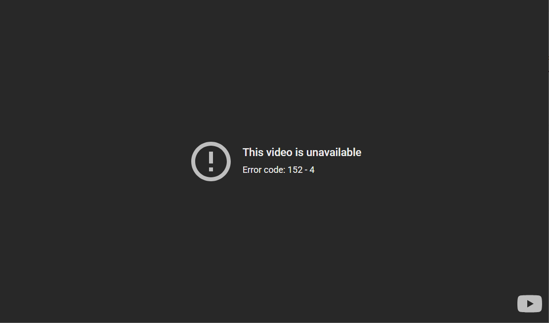

Further, when I click the video link under the "Device Registration" section, I get an error message:
This video is unavailable
Error code: 152 - 4
I found another video online which shows how to do a local configuration of the AP, in which they were able to get the wizard to appear. In an attempt to "force" it to the configuration wizard, I copied the URL for that page (although I changed the IP to the one assigned by my router), but even that will not get it to open. Instead, it just takes me back to the AP login page and makes me login again, which puts me right back where I started.
I updated the firmware from the version it shipped with to the one listed above, then did a pinhole reset of the AP, but the wizard will still not open, and this is seriously irritating me. How do I get this thing OUT of Nebula so I can configure it locally? This is NOT giving me a good first impression of Zyxel products…. 🤬🤬

    Hi @xunil76,
    Thank you for your feedback—my intent was to highlight a quick self-service option you could use immediately, but let me provide the other methods for independently restoring an AP to a standalone state without Nebula involvement:
    • First, disconnect the AP from the internet.
    • Then, press and hold the reset button for more than 5 seconds until the LEDs flash, triggering a factory reset. Alternatively, download the free ZON Utility from our website. With the AP powered on but offline, use the utility to detect and factory reset it.
    • Finally, access the local GUI (default IP: 192.168.1.2) and select Standalone Mode. This disables NCC discovery, so the device won't reconnect to Nebula even after going online.
    In this case, the AP will return to factory state for standalone management. Note that these methods do not change the device's registration status in Nebula—it stays linked to the previous organization until we remove it from the backend.
    Apart from scanning the QR code on the device sticker via Nebula mobile app to remove the device from NCC, if users need a complete removal from the original Nebula account for full ownership transfer, they must provide proof of purchase (e.g., invoice/receipt) along with the device serial number and MAC address. We'll verify and handle the backend removal promptly.
    Hope this clears things up!
