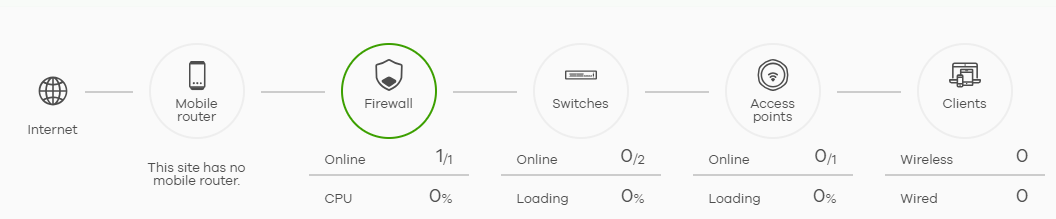

At one customer we have huge issues with an USG Flex50h and Switch GS1920-24HP.
the devices are like once a week offline. For example: what i see now:
one computer is online, because it is connected by the WIFI from the neighbours. (so not through zyxel devices). When i try to ping the firewall:
We allready replaced firewall and switch. But no result. after one week the same issues again.
When i try the remote configurator of with nebula, i get the message: device offline.
The strange thing is, why can't i ping the device? normaly absolutely possible. It seems the device completely hangs.
What can i do? this has to be solved quickly.
If it was the internet connection only, why does the device not respond at all anymore?

    The computer is online, because they use wifi from the neighbours now. So i took control of this computer, and i see the lan adapter has no dhcp adress received from the firewall. So i put an static address on this adapter. and tried to ping the firewall. no response at all.
    but also in nebula, when i try to create an remote control session it tells me, the device is offline, but in the dashboard its online?
    strange isn't it?
    i'm sure when we do an reboot the devices will come online again.
    Last week i also had one customer, where an firewall was offline, and not responding at all. after an reboot everything came back online again.
