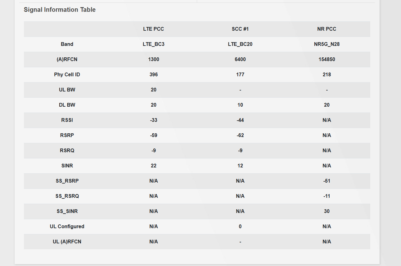

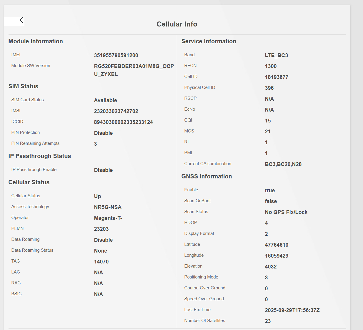

    Signal strength (SINR value):
    The current SINR value is 22 dB, with overall excellent and stable signal quality.
    Cellular access technology is NR5G-NSA with carrier aggregation (BC3 + BC20 + N28).
    No cellular reconnects are observed.
    Confirmation of IP Passthrough mode:
    IP Passthrough is disabled.
