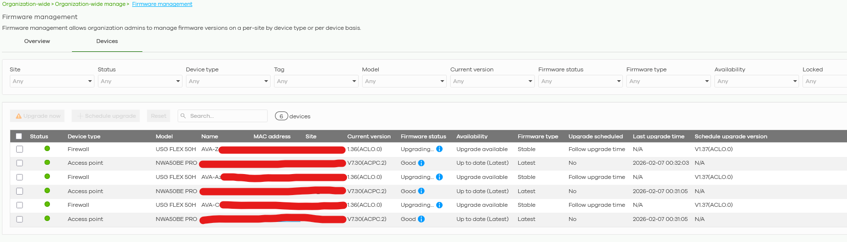

Hello everyone,
this night at 02.00 was planned an update to a 200H to 1.37.
Right now I still see the alert:
about the update that should have been done, but the firewall is still at 1.36:
Have I to update it manually via local UI?

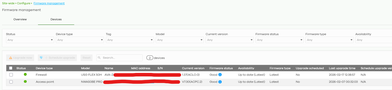

  • GiuseppeR
    GiuseppeR Posts: 762 image  Guru Member
    Hello everyone,

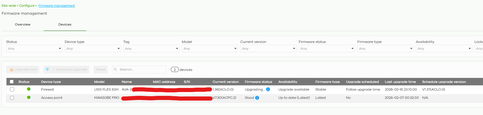

    when forcing the update from Nebula, not all the H series firewalls go for the update:
    So I used also Nebula App to push the update.
    No positive results for all the devices I was "Upgrading" looking at the Nebula web UI.

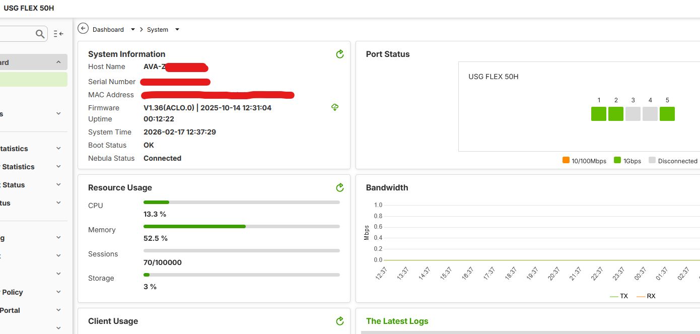

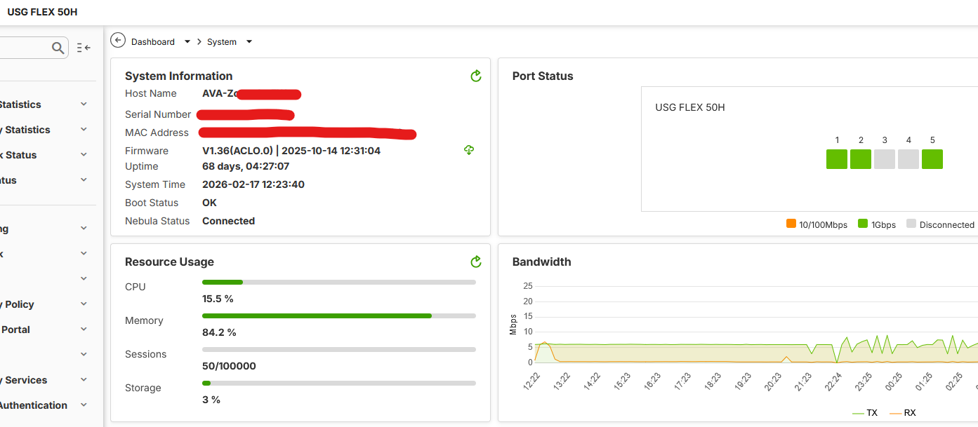

    As you can see this one:
    Needed a manual reboot before the update to 1.37:

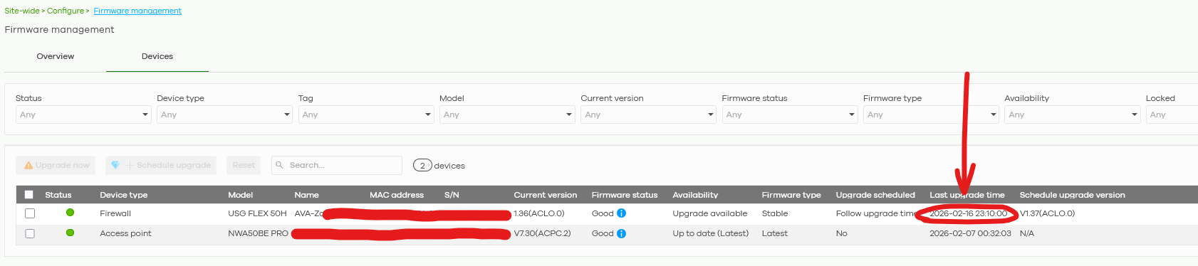

    As you can see on Nebula there is the wrong timestamp for the last update (that timestamp is the last attempt made via Nebula App with NO success…):
    Then I went to the Nebula area where to push the update:
    And then FINALLY I have the firewall updated:

  • Zyxel_Melen
    Zyxel_Melen Posts: 5,005 image  Zyxel Employee
    Hi @GiuseppeR
    No, the firmware I mentioned is V1.37 patch1.
    About the firmware upgrade issue you encountered, I have checked the event log, which shows "[Nebula] Automatic firmware update was unsuccessful. Please reboot the device first,….". This issue is more likely due to the firewall not having enough storage to hold the firmware file and process the firmware upgrade. Rebooting the firewall can help clear the temp and free up storage.
