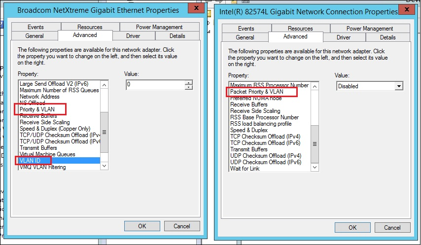

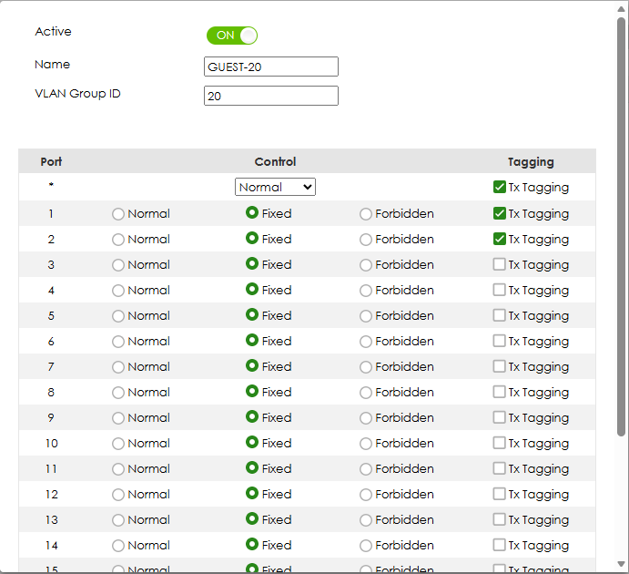

For implement your network as requested you need to create at least one VLAN interface with tag id 1 for manage the switch (or disable the VLAN management from the switch), and then you need an access point that can create VLAN segmentation based on SSID. Also, you can create a series of VLAN on your switch, but the VLAN tag is needed also from source (IE: A PC by default not have VLAN ID so it's traffic is untagged; to create a VLAN ID tag you need to modify network interface properties to create a VLAN if is supported by your network adapter)
I personally manage my network as you requested but I have as access point the NWA130BE that can create multiple SSID with VLAN network.

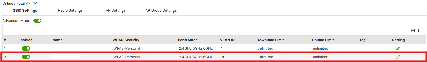

So, in this way I created:- Managed SSID with VLAN 10
- Guest SSID with VLAN 20
- IoT SSID with VLAN 100
In this way, every devices attached to the SSID take the correspond VLAN ID. So a phone attached to the Guest SSID take the VLAN ID 20.

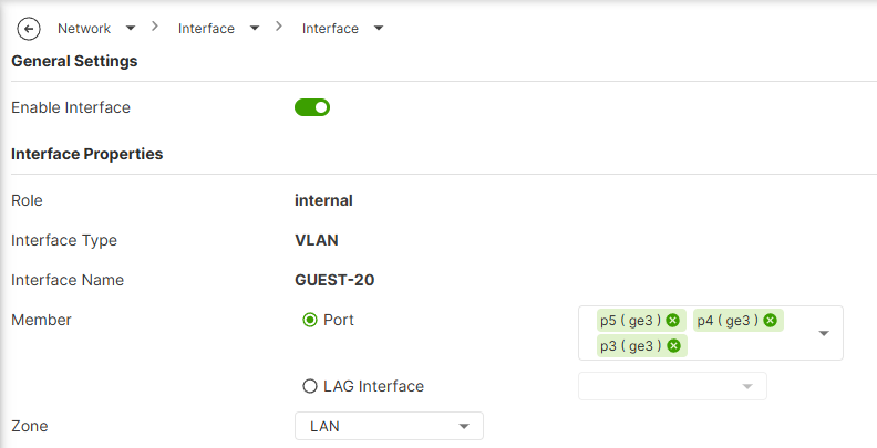

After this, I have created N interfaces into my firewall, one for every VLAN, in this way I can manage different IP&Subnet classes, Policy Rule, etc etc for every VLAN. Obviously, into the firewall, the port member are the same VLAN to VLAN, because all these VLANs are coming from the same access point attached into the same one port on the firewall.
Other this, I've created a Management VLAN with tag 1 that I use to manage the network devices (Access Point/Switch etc etc).

On the other hand, regarding the VLAN setup, as mentioned by PeterUK and Maverick87, the Fritz Repeater 6000 does not support VLAN, and VLAN segmentation is not based on using multiple Ethernet cables, but rather on VLAN tagging mechanisms.
From your current network environment, the Fritz Repeater 6000 operates as a device that forwards traffic without VLAN tagging capability. This means all client traffic from the repeater is transmitted as untagged traffic.

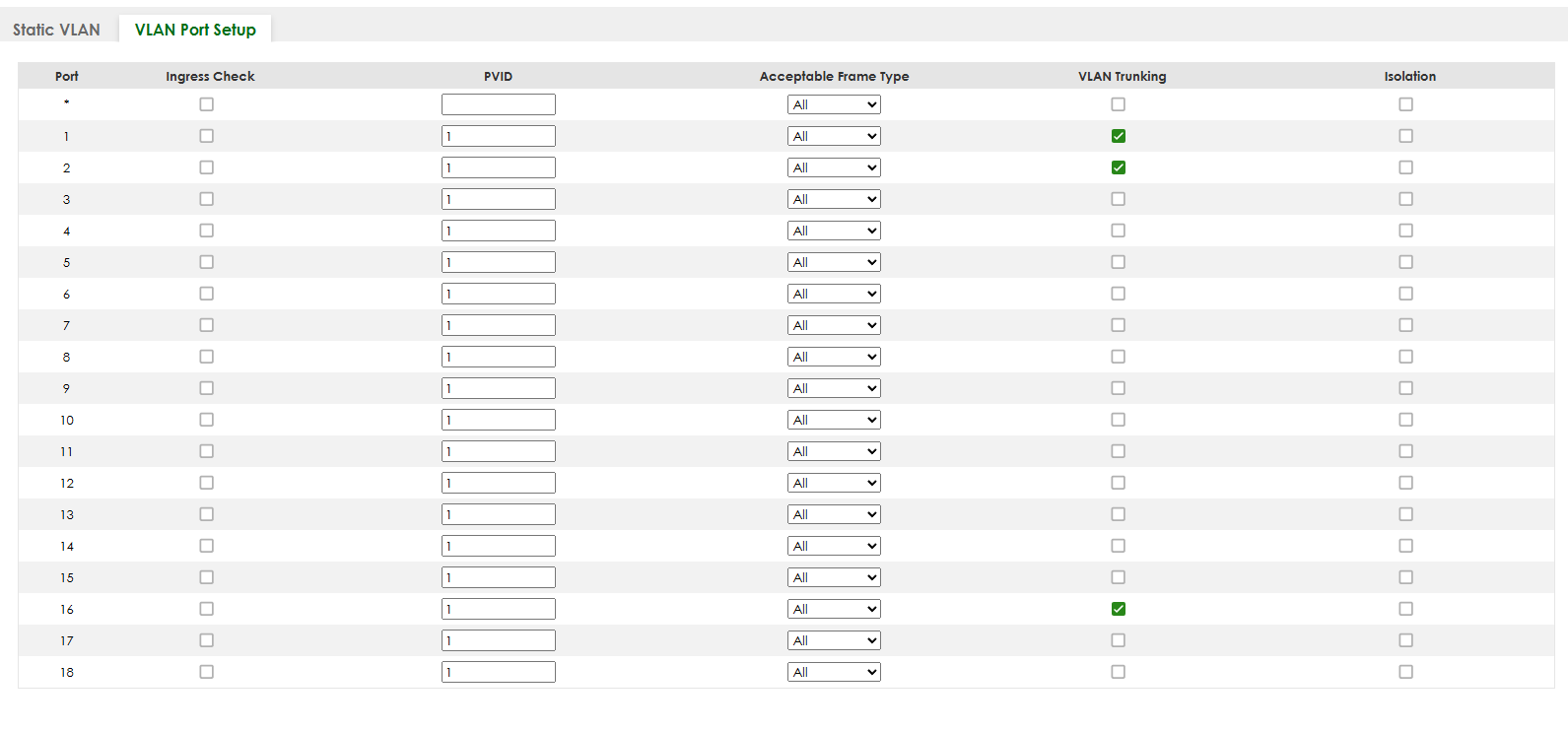

If your goal is to separate general LAN and a specific VLAN, one possible approach is to configure a PVID on the switch. For example, assigning a specific PVID (e.g., VLAN 10) to the switch port connected to the repeater allows all incoming untagged packets from that port to be associated with that VLAN.
With this setup, the switch can separate traffic between different interfaces. However, since the repeater forwards all traffic without VLAN tags, all connected client traffic will be treated as part of the same VLAN. This makes it suitable for single VLAN assignment per port.
