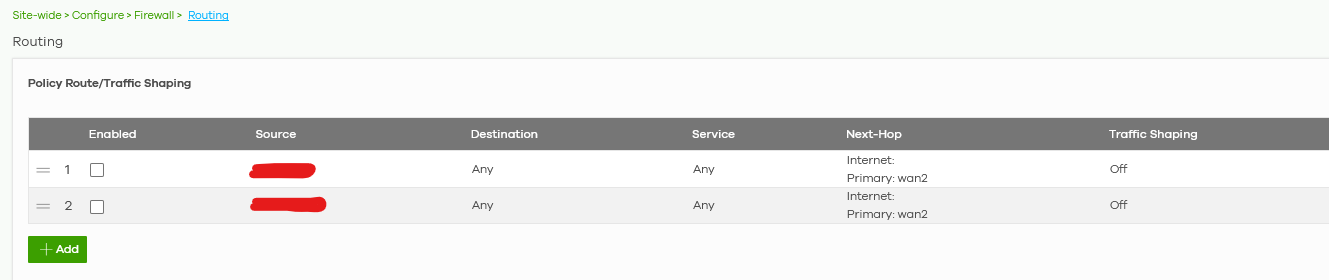

I went to this section:
to route a pair of specific LAN devices via wan2 internet connection.
I have 2x wans on that site but I need that both of those LAN devices go on the internet ONLY via wan2. No backup via wan1.

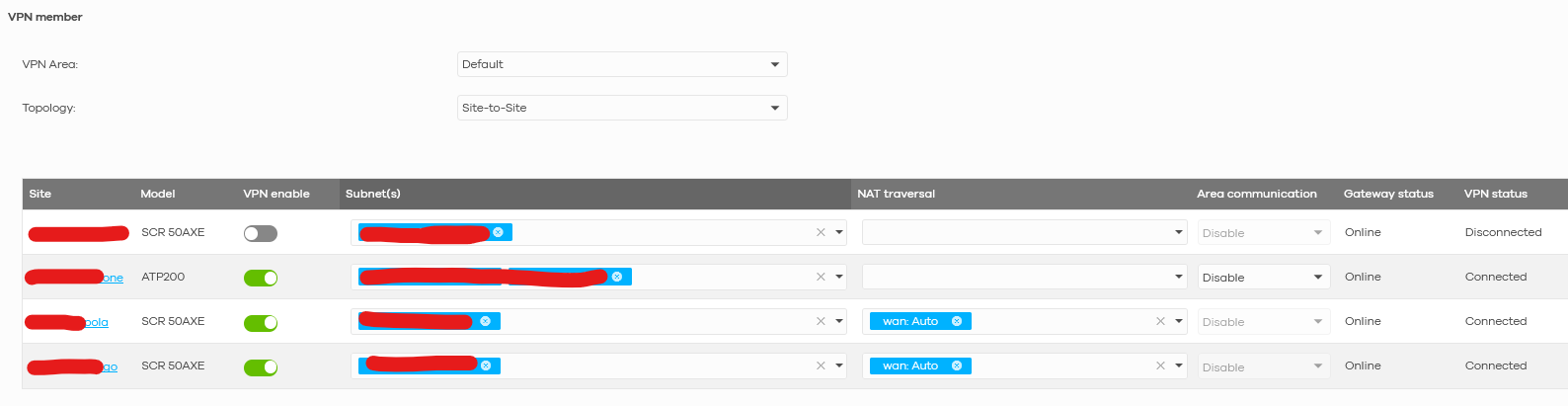

The problem is that I have also a VPN (VPN that is working via wan2 only too) on that ORG:
So when those rules are enabled I am NOT able to use internal VPN to reach those devices. Neither ping or smb connection.

Hi @GiuseppeR ,
The issue occurs because your current Policy Routes use "Any" as the destination and the policy route has higher priority than site-to-site VPN in routing flow. Since the VPN subnets are technically "Any" destination, the firewall prioritizes the Policy Route and pushes that traffic out through WAN2 instead of routing it through the VPN tunnel.

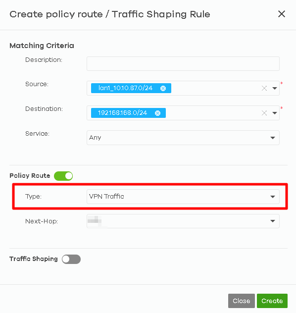

Hi @GiuseppeR
Here is the solution:
Please help to add a new policy route at the first priority. Below is the example:
With specific scr and dst lan IP range, the firewall will direct the matched traffic to VPN tunnel. The other traffics will follow the rest of routing rules.
Zyxel Melen0 -

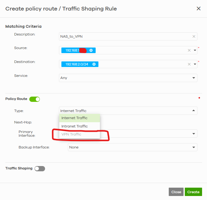

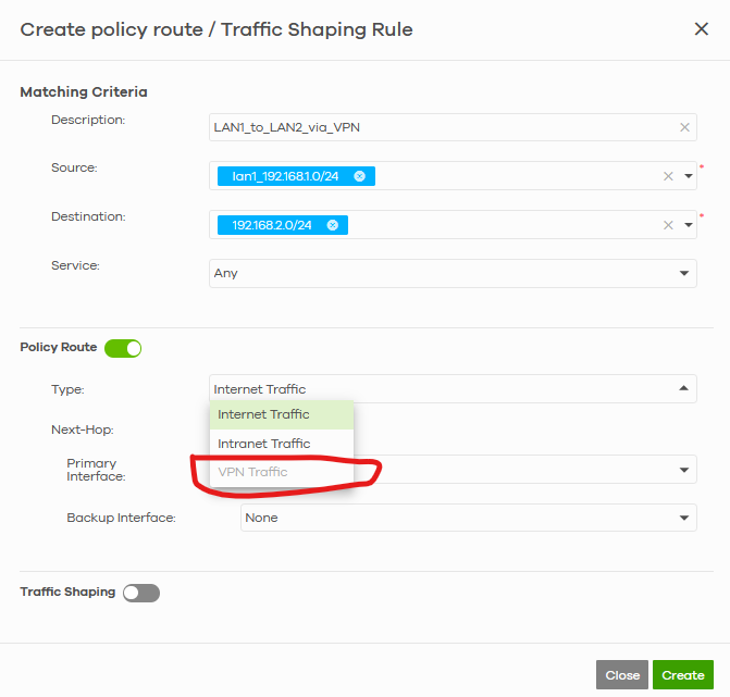

Hi @Zyxel_Melen
Nebula did not let me use VPN tunnel for a specific IP:
As you can see I wanted to send the traffic from NAS IP to all the LAN2 subnet (on a remote Zyxel device linked in VPN) but it is grey.
Neither via entire subnet:
0 -

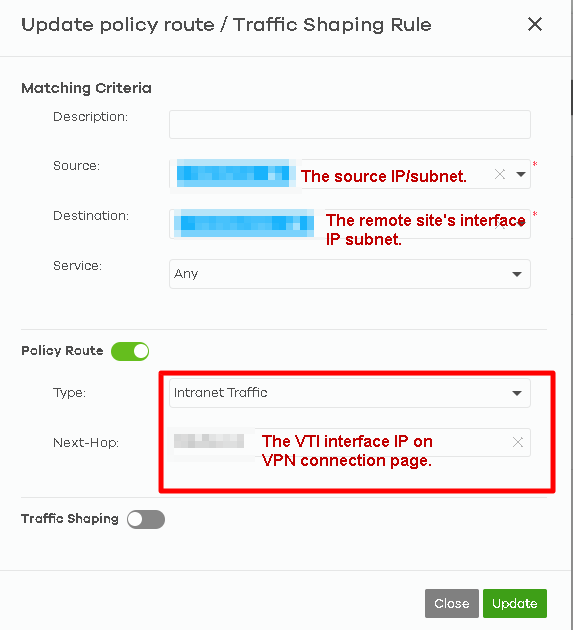

Hi @GiuseppeR
Thanks for the privilege. Update a short conclusion in here:
The VPN tunnel are route-based VPN, so we can reference the VPN information on VPN connections page to set the policy route rule.
Zyxel Melen0 -
Hi @Zyxel_Melen
your solution is great. 😎
For the newbie I would like to add suggestions about how to compile the values.
Let's make an example.
You want to route an IP like 192.168.1.10 (or a subnet 192.168.1.0/24) to 192.168.2.0/24 via VPN tunnel made by Nebula VPN Orchestrator.

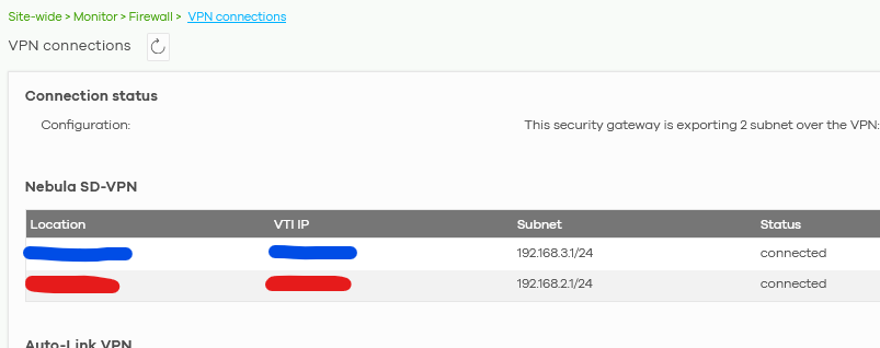

So you have to go to this page:
Take note about YOUR values under VTI IP and place them here (Melen reference guide in the post above):
I have 2 locations, so blue VTI IP is needed to reach 192.168.3.1/24 subnet and the red one accordingly to reach 192.168.2.1/24 subnet
