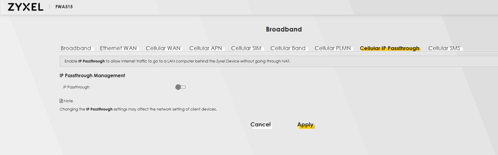

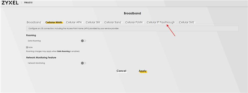

Accepted Solution
Hi @BenJan
We can replicate this issue, which occurs after factory default. Please help to upload the latest firmware again. After upload, the option will appear in Network setting > Broadband.
Firmware download link:
https://download.zyxel.com/Nebula_FWA515/firmware/Nebula%20FWA515_1.60(ACPZ.0)C0.zip
Zyxel Melen0
Hi @BenJan
Zyxel Melen0 -
Thanks for the tip. I succeeded using that info.
Testing the new firmware update (160ACPZ0-DF-20260319) next week.
All good.1
