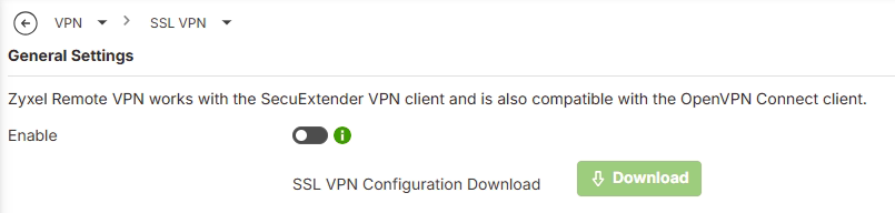

    just to be clear your talking about this setting

    There shouldn't be any connection with the firewall's OpenVPN module, which isn't being used (and is disabled): the firewall is simply redirecting TCP and UDP network traffic to a third party VPN server in the DMZ.
    Thank you very much for your help.
