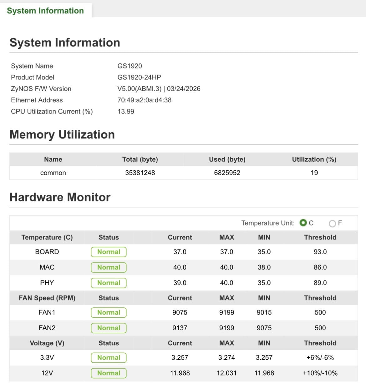

Is it normal for the fans to be running at full speed with temperatures near or just below 40°C? I understood that the v2 included smart fan control and, whilst the temps aren’t very low, the fans are very loud. I’ve tried updating to the most recent firmware and multiple reboots but the fans continue to startup and run at 9000rpm continuously without ever seeming to ramp down. Is there a fan speed vs temp curve you could share? Thanks for any advice.

Hi Zyxel_Tina,
Thanks for the reply, in answer to your questions no, there were no SFP modules installed and the total Poe draw was around 16-18W, so minimal. Having read about the potential for a link between high fan speed and SFP module usage I moved three links that were using the combo rj-45 ports 25-27 into 22-24 instead and on reboot the fans dropped to a far more reasonable level around 3000rpm - is this an intentional response to using these rj-45 ports, or a firmware foible?!
Unfortunately, however, under 24hrs later both fans reported an error and the status readout shows they have completely stopped - both failed at the same time and haven’t restarted despite several reboots and a reset to to factory defaults - I’ve raised a ticket for this, awaiting a response from the support team. I’ve provided remote access authorisation, but happy to share the diagnostics with you directly too - I’ll try to send that over shortly.0 -
