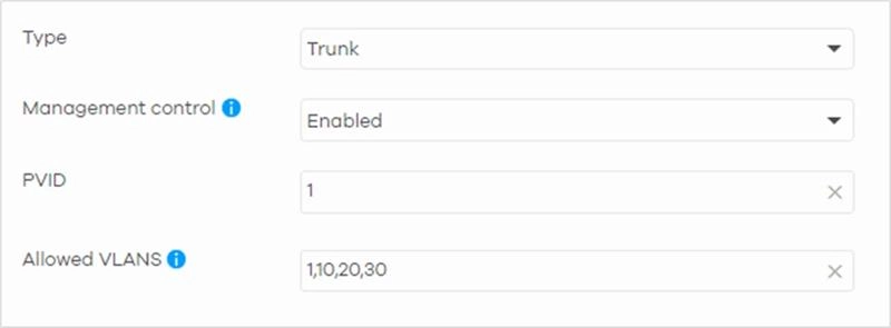

    For your goal of maintaining explicit VLAN separation for a multicast AV-over-IP system on a Nebula-managed GS1920-48HPv2, you can still achieve this — but the port/VLAN configuration should be done through Nebula, not the local GUI, once the switch is Nebula-managed.
    As an example, using VLAN 10/20/30 tagged for your multicast AV-over-IP system, you would configure it as below (note that VLAN 1 remains untagged):

    So, Nebula is effectively the authoritative source once the switch is under Nebula management — any local Static VLAN changes made directly on the switch can be overwritten the next time Nebula push configuration. For a Nebula-managed switch, we'd recommend configuring VLAN membership (Access/Trunk, PVID, Allowed VLANs) exclusively through Nebula to avoid the conflicts you're seeing.
    Regarding "Normal, Fixed, Forbidden, and Tx Tagging" definition in Nebula, Nebula simplifies these traditional command-line/GUI concepts into a cleaner, state-based UI:
    • Tx Tagging (Tagged): On a Trunk port, any VLAN listed in the Allowed VLANs field (excluding the PVID) is configured as a Tagged member (equivalent to Fixed + Tx Tagging).
    • Tx Untagging (Untagged): The VLAN ID defined in the PVID field is always untagged on egress.
    • Forbidden: Any VLAN that is not entered in the Allowed VLANs list on a Trunk port or is not the designated PVID on an Access port, is automatically excluded from that port’s membership.
