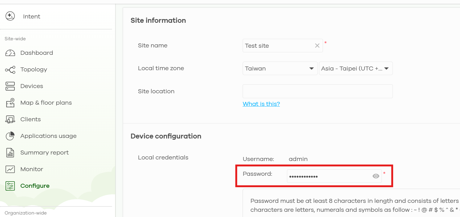

The local Web GUI "admin" account password can be found under Site-wide > Configure > Site settings.
