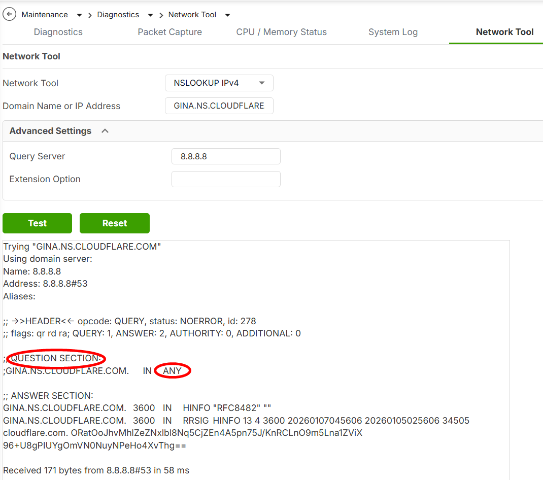

Over the last couple of months we are running into issues with certain FQDN objects that will not properly resolve to an IP. Doing a bit of research, it seems some internet DNS servers are beginning to implement RFC8482 which does not allow DNS queries with QTYPE=ANY, which is the query type sent by the zywalls. Sometimes the queries succeed, but increasingly they are failing, I assume because DNS providers are slowly rolling this out on a percentage of traffic so we can discover/fix this type of issues.

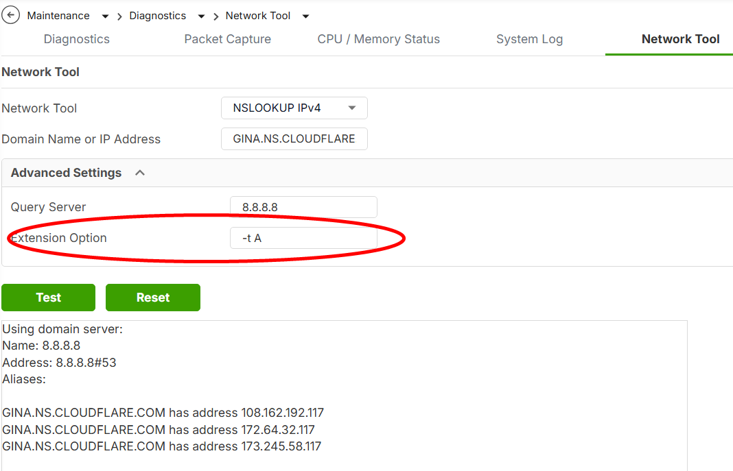

Using the nslookup tool in the Diagnostics menu of the firewall, the affects of this RFC being enforced can be observed. If I force the firewall to do an A record query instead of an ANY query, the hostname successfully resolves and populates the cache, allowing the FQDN object to then function properly.

Failed query using firewall's default query type:
Successful query using extension option forcing QTYPE=A

    -lookup zyxel.com using 'query server' 1.1.1.1 on Network Tool page of USG, it will fail with NOTIMP
    -all query with QTYPE=ANY against cloudflare public dns service 1.1.1.1 will fail with NOTIMP error

    It is the Diagnostics tool that defaults to any record

    In my case which prompted this post, this bug you mentioned was compounded by the 'test' function on the FQDN object sending an ANY request to cloudflare, who is enforcing RFC8482. So the test function was not pulling the IP into the cache/FQDN object until an 'A' lookup was done, then it got the IP. I never did a packet capture to see exactly what was (or not) happening, also just assumed the FQDN/firewall issue would affect ZLD since it's built-in tests also send ANY queries.
    What you are saying does make sense, I guess when running nslookup tool on the 100H with the '-t A' option to force an 'A' lookup, it must have populated the cache and allowed the FQDN object to function.
