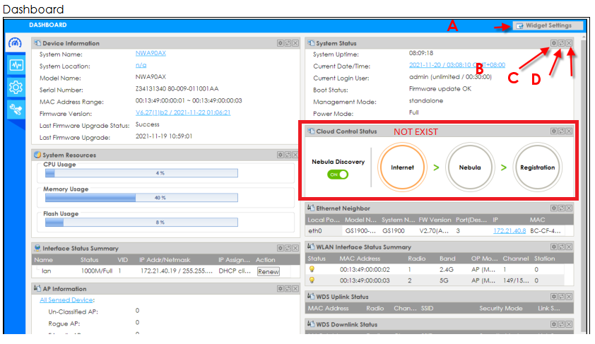

    Nobody replies so i try to register the products to nebula.
    The sw is ok its online, but the problematic AP is offline.
    I used to switch off that nebula discovery option and now with the newest fw it does not exist anymore and nowhere else can find the on-off switch of the cloud.
    I opened the 4335, 6667, 123 ports also but nebula cant find the ap.
    And I really dont understand why the sw's web management login page deny me with "Invalid username or password." message aftr the nebula registration.
    I don't want fall out of love with Zyxel.
