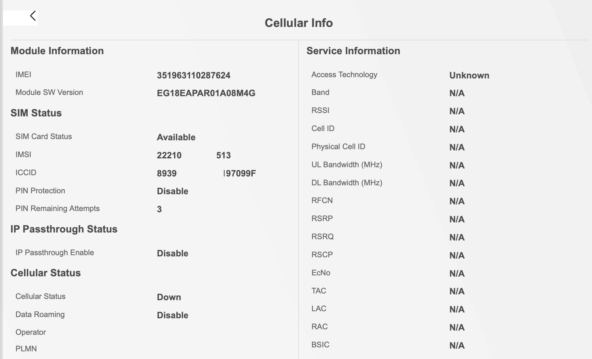

Usually I use an Iliad SIM in the above modem/router.
Today I wanted trying a Vodafone SIM, usually used by my iPad.
Surprise surprise, does not work in the Zyxel.
The SIM is recognized but there is no 4G connection.
I tryed both, auto and manual APN configuration with no success.
By the way, I already found this article and manually set the APN with IP V4….
Enable":true | |
"APN":"web.omnitel.it" | |
"Interface":"Cellular.Interface.1" | |
"X_ZYXEL_ManualAPN":true | |
"X_ZYXEL_AuthenticationType":"None" | |
"X_ZYXEL_PDP_Type":"IPv4" | |
"Alias":"" | |
"Username":"" | |
"Password":"" | |
"Proxy":"" | |
"ProxyPort":0 | |
"X_ZYXEL_Name":"" | |
"X_ZYXEL_BridgeMode":false | |
"X_ZYXEL_MTU":0 |
Attached below the 2 log for auto and manual APN configuration.
Thank you to anyone can help and provide a solution.
I solved the problem.
For some reasons seems that with this SIM and/or provider a manual PLMN selection is required. 😕
