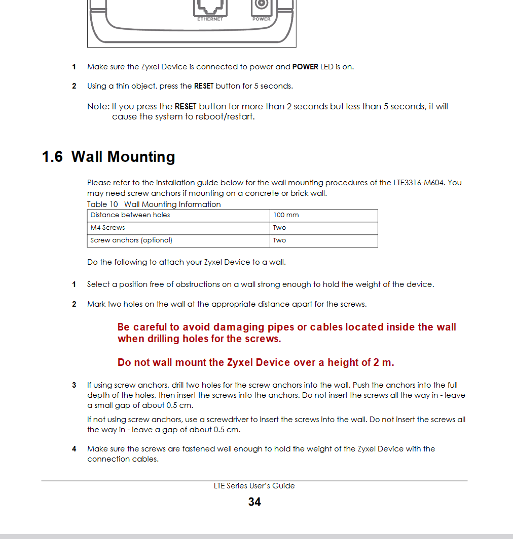

Which I have now done. Now one other quick question that you may be able to answer. It says in the LTE74904 user guide, but not the quick start guide, not to mount the device at a height over 2m.
1 Why is this?
2 If so why does the quick start guide show it mounted high up at the top of 2 floor house?

Please take a screenshot of that text....
0 -
Hi
Screenshots attached.
Screenshot A is taken from the users manual and as you can see the second line in red type mentions the 2m limit

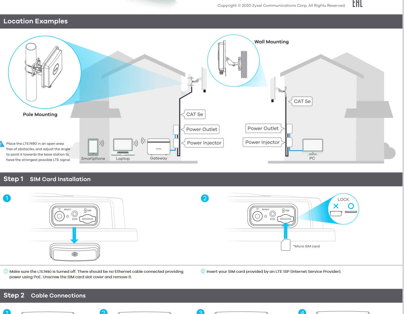

Screenshot B taken from quick start guide and shows unit mounted at top of house wall. Either it is avery small house or is along way over 2m.
Thanks

My antenna is about 4 meters up on the wall.
I have better signals from there than up on the roof.
