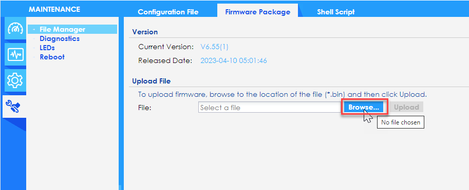

- Click Maintenance > File Manager > Firmware Package
- Click Browse... to find the .bin file you want to upload. Remember that you must decompress compressed (.zip) files before you can upload them.

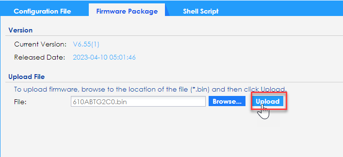

4. Click Upload to begin the upload process. This process may take up to two minutes.
5. After you see the Firmware Upload in Process screen, wait two minutes before logging into the AP again.
