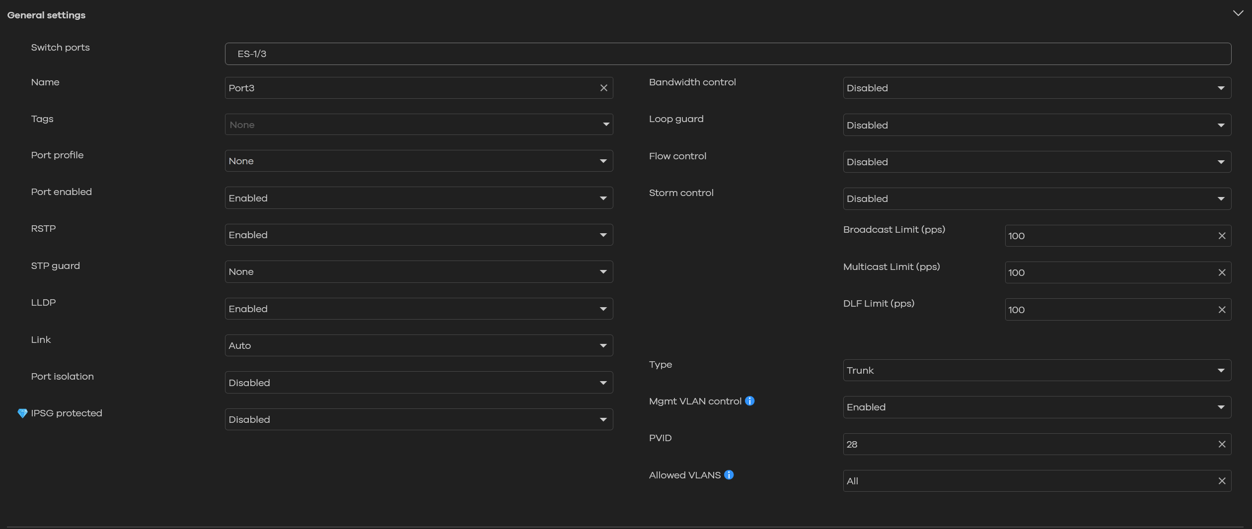

Hi @Zyxel_Tina ,
I tried setting the Access Points to untagged, assigning the PVID of the management VLAN to the switch port, and everything works correctly — both the connection to the AP (take correct IP) and the WiFi networks it provides.
However, if I set VLAN 88 as Tagged on the Access Points for management VLAN ID, the APs get the correct IP address, but when trying to connect to the WiFi network provided by the Access Point, the devices don’t receive any IP address.
0 -
Hi @Alex_91,
Thanks for the update. From your description, the issue seems related to the SSID VLAN mapping. Please check the following:
- What VLAN ID is configured for the AP’s SSID? If it is set to 28, the clients may not be able to obtain an IP address. This is because the switch will untag packets whose VLAN matches the port PVID.
- Alternatively, you may change the switch port’s PVID to an unused VLAN ID, for example, 2000. As a result, when packets pass through the switch to the AP, they will remain tagged, allowing clients to correctly receive IP addresses from the corresponding VLAN via the SSID.
If you have further questions, feel free to ask.
Zyxel Tina
