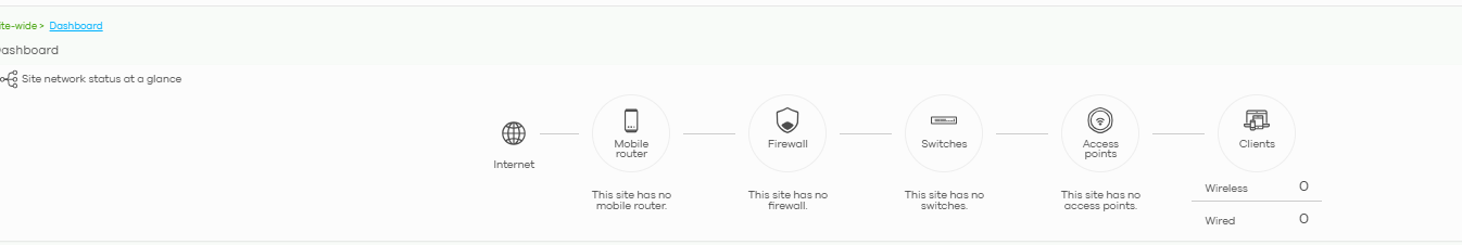

i removed the firewall from the organisation. Now my dashboard is like this:

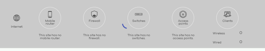

now i add the firewall again

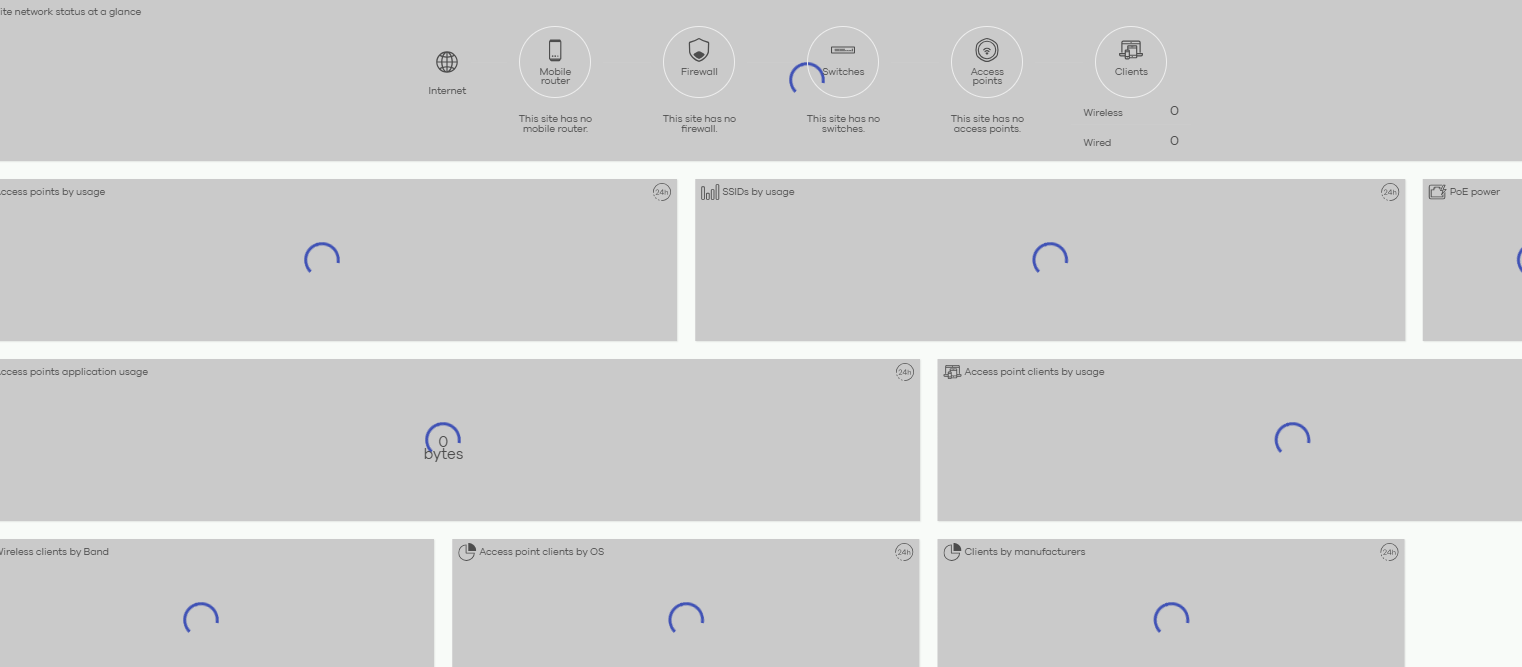

and directly:
i can't imagine this isn't easily reproducable for you. It's not only with this firewall, but also with a firewall from a customer.
so it's not organisation depended
