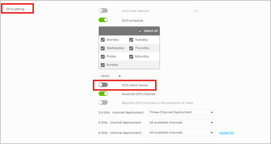

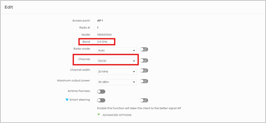

2. Dynamic Channel Selection (DCS) Configuration
Channel interference on the root AP can disrupt smart mesh connections. To resolve this:
Enable DCS:
(1) Navigate to Configure > Access Points > Radio Settings
(2) Scroll to the radio section (2.4 GHz or 5 GHz)
(3) Click on your target AP and select the Edit button
(4) Select DCS for the channel option
Disable 'DCS Client Aware':
(1) Navigate to Configure > Access Points > Radio Settings > DCS Settings
(2) Disable the DCS Client Aware option
We recommend disabling 'DCS Client Aware' because when this option is enabled, the AP will not switch to a better channel if there are clients currently connected. Disabling this option allows the AP to switch to a channel with better signal quality even when clients are connected, which helps maintain optimal mesh network performance.

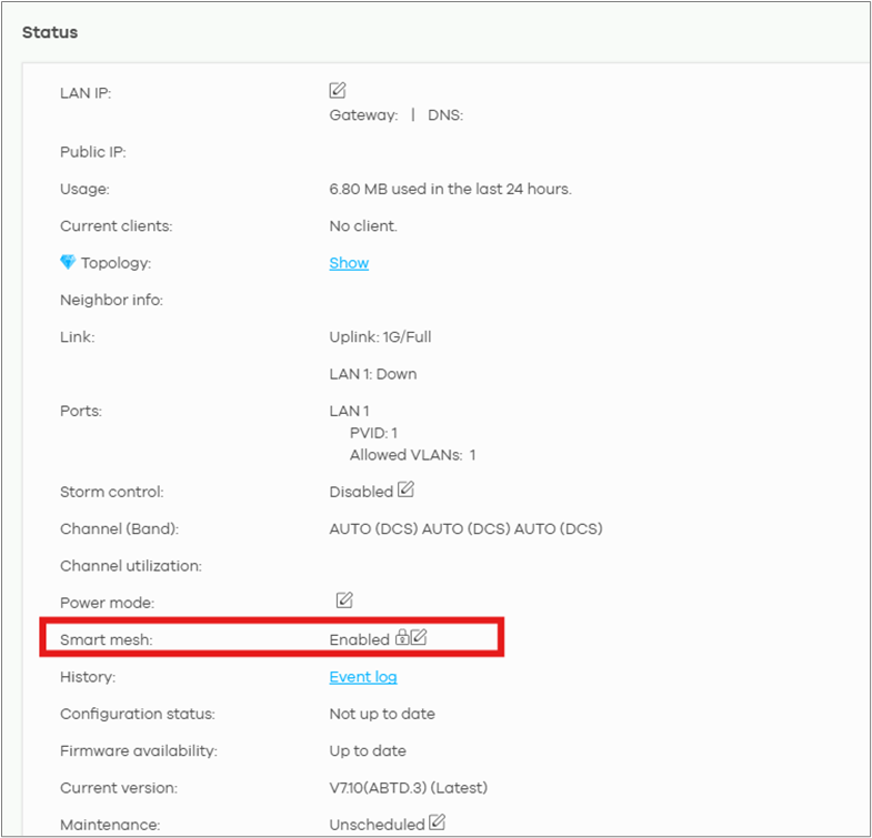

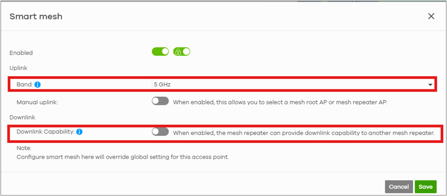

3. Smart Mesh Mode Configuration
(1) Navigate to Device > Access Points and select your target AP
(2) Go to Status > Smart Mesh and click the configuration button
Avoid using "Auto (High Band Preferred)" mode – this setting causes the repeater AP to constantly evaluate connection quality and may trigger frequent band switching in unstable environments, resulting in disconnections.
What's more, there are also some considerations in relation to the Band Selection Trade-offs. When configuring your mesh connection, please consider the following:
- 2.4 GHz band: Provides better signal strength and longer range, but offers lower throughput and performance
- 5 GHz band: Delivers higher throughput and better performance, but has weaker signal strength and shorter range
We recommend choosing the band based on your specific deployment:
- Use 2.4 GHz if your repeater APs are farther from the root AP or if maintaining stable connections is the priority
- Use 5 GHz if your repeater APs are closer to the root AP and higher throughput is required
Also, for repeater APs that are already 2 hops away from the root AP, please disable their downlink capability to prevent additional APs from connecting through them.

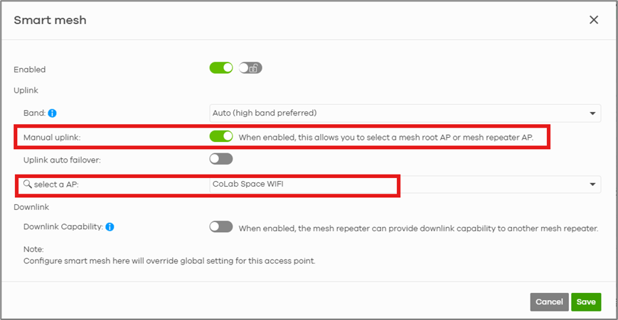

Hi @Bootstrap,
I've reviewed your network configuration and identified that you have two root APs in your environment. This setup can cause repeater APs to switch between root APs based on signal strength, leading to unstable mesh connections.
Recommended Solution: Manual Uplink Configuration for each Repeater AP
To prevent mesh link changes and stabilize your network, please manually fix the uplink root AP for each repeater AP by following these steps:
Step 1: Position the repeater AP close to your preferred root AP
Example: Place "COLAB Repeater 2" near "COLAB Space wifi"

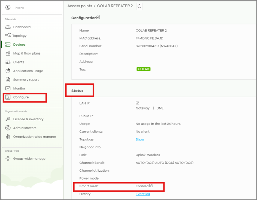

Step 2: Access the repeater AP's configuration:
- Navigate to the repeater AP's device detail page (e.g., "COLAB Repeater 2")
- Go to Status > Smart Mesh
- Click the Edit button
Step 3. Configure manual uplink:
- Enable the Manual Uplink option
- Select your preferred root AP (e.g., "COLAB Space wifi") as the fixed uplink
- Save the settings
Step 4. Repeat for the other repeater APs in your network
After fixing the manual uplink configuration for the repeater AP , please measure and verify the uplink signal strength for each root AP
Important: If the uplink signal strength of the Root AP is below -70 dBm, the mesh connection may be unstable and prone to disconnection. In this case, consider:
- Adding additional APs to improve coverage
- Removing obstacles between APs
- Use the Ethernet uplink for the APs
Please let me know the signal strength readings after implementing these changes, and I'll be happy to provide further assistance.

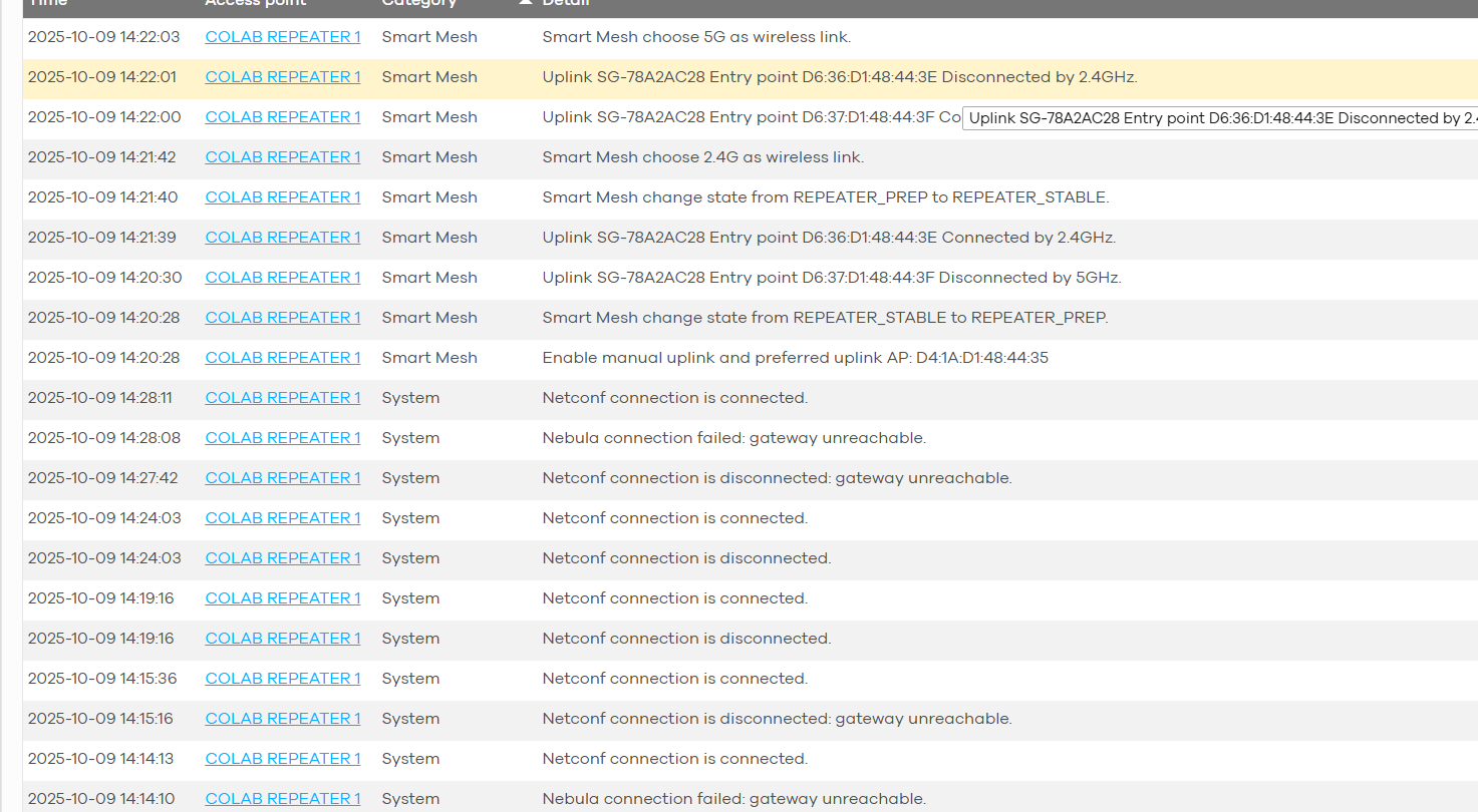

We are still having issues with the repeaters. I attach a picture of the log of one of them; they are both disconnecting due to "Netconf connection" disconnecting and connecting. Any advise on this?
We will then look to connect the repeater APs with ethernet but this will require cabling which we are trying to avoid if possible.
Thank you!
