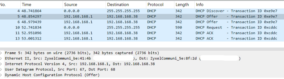

As mentioned before, when connecting a GS1915 switch directly to a Zyxel firewall (e.g., USG FLEX 200H), the switch obtains a DHCP IP properly without issues. In our test, we confirmed the DHCP process completed successfully with the full Discover → Offer → Request → ACK sequence. This verifies that the GS1915 functions as expected.

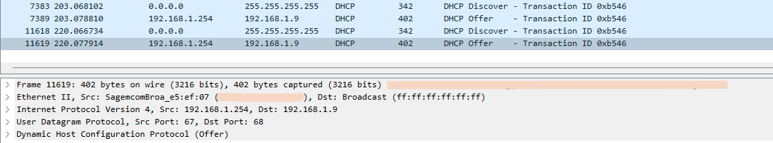

Comparing our capture with yours, we noticed a difference in how the uplink router delivers the DHCP Offer. In your environment, the Offer is sent as an Ethernet broadcast (ff:ff:ff:ff:ff:ff). The GS1915, following standard DHCP client behavior, discards Offer packets not addressed to its MAC address, which prevents the handshake from proceeding.
Therefore, we recommend reaching out to the router vendor to investigate this issue.

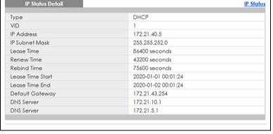

Before proceeding, could you please confirm whether the switch can ping the router and the internet? Also, please provide a screenshot from the switch GUI under Basic Setting > IP Setup > IP Status Details. For example
