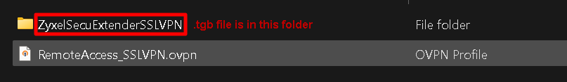

I’m trying to generate an .ovpn configuration file for SSL VPN, but instead of getting an .ovpn file, the system downloads a .tgb file when I click the “Download” button in the SSL VPN section.
I expected to receive a standard OpenVPN (.ovpn) configuration file, but I’m not sure why it’s generating a .tgb file instead.
Is this the correct behavior for this model/firmware, or am I missing some configuration step required to generate the .ovpn file?
I would appreciate any guidance on how to properly obtain the .ovpn file.

    May I know your running firmware version is latest version? If not, please help to upgrade first.
    I checked the download file in my lab with latest version, I can get .ovpn file and .tgb file at the same time.

    Hello,
    We managed to solve the issue.
    The problem was resolved by performing a factory reset and initializing a completely new configuration on the Flex 500H. After that, the option to generate the .ovpn file appeared correctly.
    Interestingly, before the reset we were already using the latest firmware version downloaded from the cloud. We also tried a manual firmware upgrade and manual firmware file upload, but neither helped. The .ovpn generation option was still missing until the device was reset and reconfigured from scratch.
