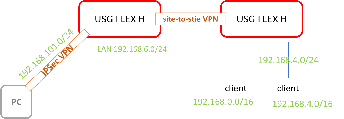

Hi Tina, I try to establish remote access to a network where multiple sites are connected using site-to-site vpn tunnels. One of the sites has a fixed WAN ip-address and is chosen as the remote-access gateway (it uses a 200H). So I did define a remote-access definition on that site with a vpn pool that is outside of any subnet on the different lans. Routing policies are in place to route traffic through the correct tunnels to the different sites based on their respective subnet. So normal traffic between sites is working correct, the problem exists only for the remote access users. I am not using Nebula. When the remote users connect, their vpn connection is established. So I see the connections in the vpn-monitor. They can ping devices on the networks that are connected to the lan of the remote-access gateway, but they don't receive a ping-reply of devices on the own lan of the gateway device. I did a packet capture and I see these devices replying to the 200H but it is not routed through the vpn-connection to the remote client.

Hi PeterUK, I do not have a specific LAN to WAN routing policy under the network tab, I do however have a vpn site-to-site connection for the other sites specified with a subnet mask (192.168.0.0/16) that also contains the RA-vpn pool (192.168.101.0/24). I used this netmask to avoid having a specific tunnel for each remote site that is behind the site I am connecting to, to reach the other sites. The sites are all connected to a main site (192.168.4.0/24), but this is not the remote access gateway site (192.168.6.0/24). Other subnets like 192.168.3.0/24 to 192.168.11.0/24 are all reacheable through the central 192.168.4.0/16 site. I guess this is what needs to be changed? How can I tackle this in the best possible way? I am a networking novice, so pointers to a good solution are welcome.
So, to summarize: RA Client connects to 200H on subnet 192.168.6.0/24 (via its fixed WAN address) and gets an ip from the pool 192.168.101.0/24. Connection succeeds. I can ping devices on all subnets except on the subnet 192.168.6.0/24. There is a site-to-site tunnel from 192.168.6.0/24 to 192.168.0.0/16 to reach all other subnets thru the 192.168.4.0/24 subnet it is connecting to.0 -

Hi @Marco64,
Based on previous discussion, I have illustrated the topology above.
In this network scenario, additional routing rules are required to ensure that the traffic is properly directed into the VPN tunnel.
If you have already configured the routing rules and the issue still persists, please provide the configuration file so we can investigate further.
Zyxel Tina
