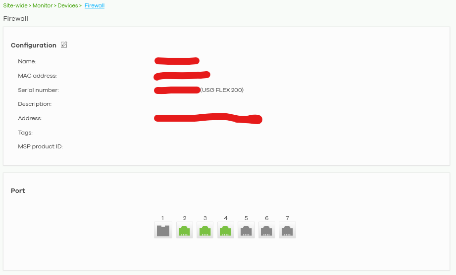

as you can see I have a firewall with 2x WANs:
WAN2 is my backup on that site.

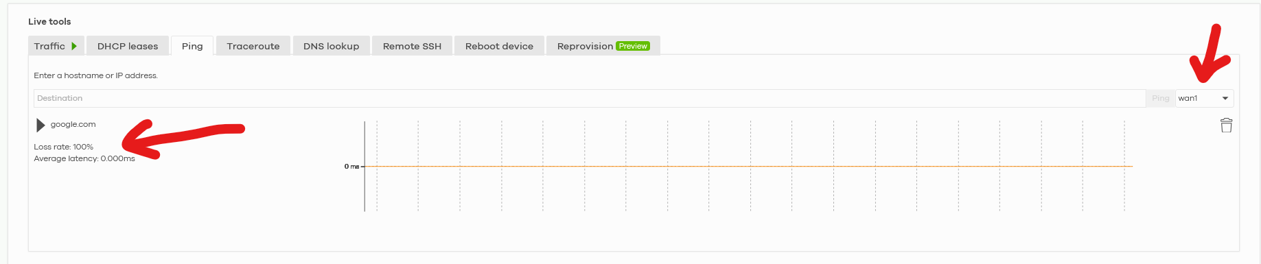

WAN1 is down:

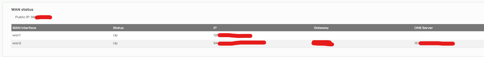

Anyway I see that it is declared as "Up":
I think it is a little bit confusing info, as you can see there is zero WAN1 traffic:

    The "Port Status" shown in Nebula reflects the physical link status of the port — it indicates whether a cable is physically connected, regardless of whether that connection actually has internet access.
    In your case, we believe the USG FLEX 200 is online on Nebula because WAN2 is currently providing internet connectivity. As a result, the device is able to report to Nebula, and WAN1's port status may still display as "Up" simply because the cable is physically connected, even though WAN1 itself has no internet access at the moment.
