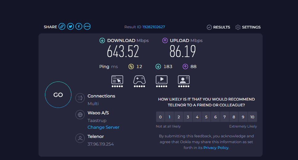

When running in NR5G-NSA/4G Auto Switch mode, the router successfully registers on the local Telenor DK tower using B7 + N78 + N3 with elite-tier signal metrics (LTE SINR: 32 dB, 5G SINR: 24 dB). Under heavy continuous load (Speedtests generating 640+ Mbps down / 85+ Mbps up), the connection holds perfectly without any drops.

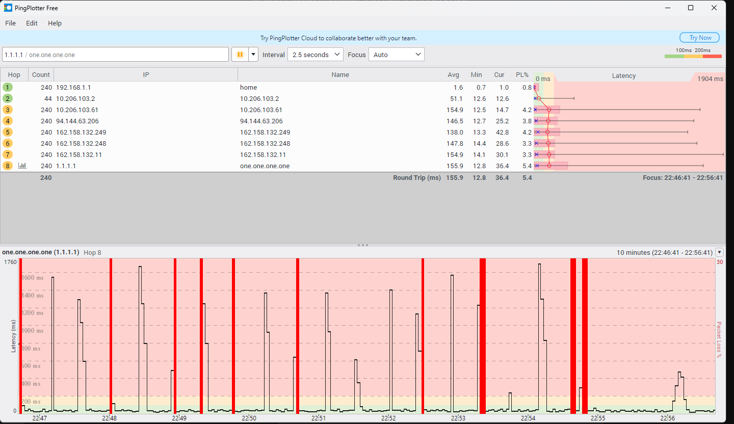

However, the exact moment the connection drops into Idle Mode, the V1.60 module firmware triggers a background frequency scan. Because of the software mismatch/bug, this background scan completely starves the active LTE transport layer, resulting in systemic blocks of 100% packet loss (PL%) every 60-90 seconds and latency spikes up to 2500ms in PingPlotter.
If I manually restrict the router to 4G Only, the background scanning stops instantly, and packet loss drops to a flawless 0.0%. A full hardware NVRAM cold-reset has been performed, but the module firmware remains stuck on the V1.60 baseband.

  1. Screenshot of the pristine Cellular Info page showing 32 dB SINR.
  2. PingPlotter timeline showing 0% loss under load, but immediate cyclical 100% packet loss blocks during idle mode.
  3. PingPlotter comparison chart showing a completely flat green line the second 4G Only is enforced.

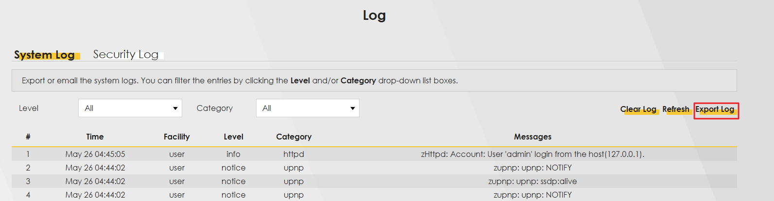

    • Collect the log after you face the "issue" you report. You can find it at:
      System Monitor > Log
