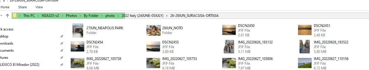

Could someone be of any help to a 70yo newbe? Have a rarely used NSA325v2, used only for photo and music storage, rarely used.
Now after months of being turned off I realized that all the image file (photo) extensions have changed! How can I roll them back to jpg?

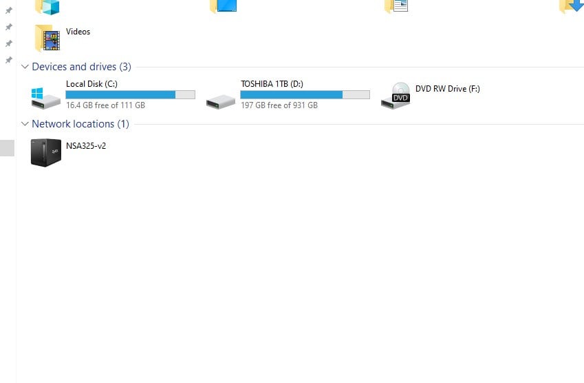

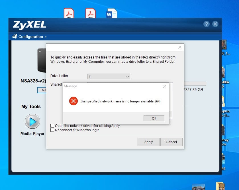

Also the network drive isnt accessible from the Zyxel starter utility. The msg says: specified network name (Volume 1 on Z Drive) NO LONGER AVAILABLE. Also the SHARED FOLDER doesnt open the NAS it opens my pc Documents file. Thank u all

    As long as I dont see and access the Z drive I can't use a cmd to change all the image files back to jpg😕
    Is it possible that you meanwhile updated your PC, or installed a newer Windows? Starting with Windows 10 the SMB1 protocol is disabled by default. And unfortunately the NSA325 doesn't support a newer protocol.
    So you'll have to enable SMB1.

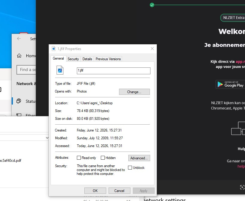

    Did you actually see the extensions changed? Or is it mere the thumbnail telling you it's a jfif file? Technically jpeg only defines the compression, while jfif defines the container. So using the jfif extension for the file is more correct than jpg.
    But from your screenshot I think the extension is still jpg, and just the viewer (Explorer?) identifies them correctly as jfif containers.

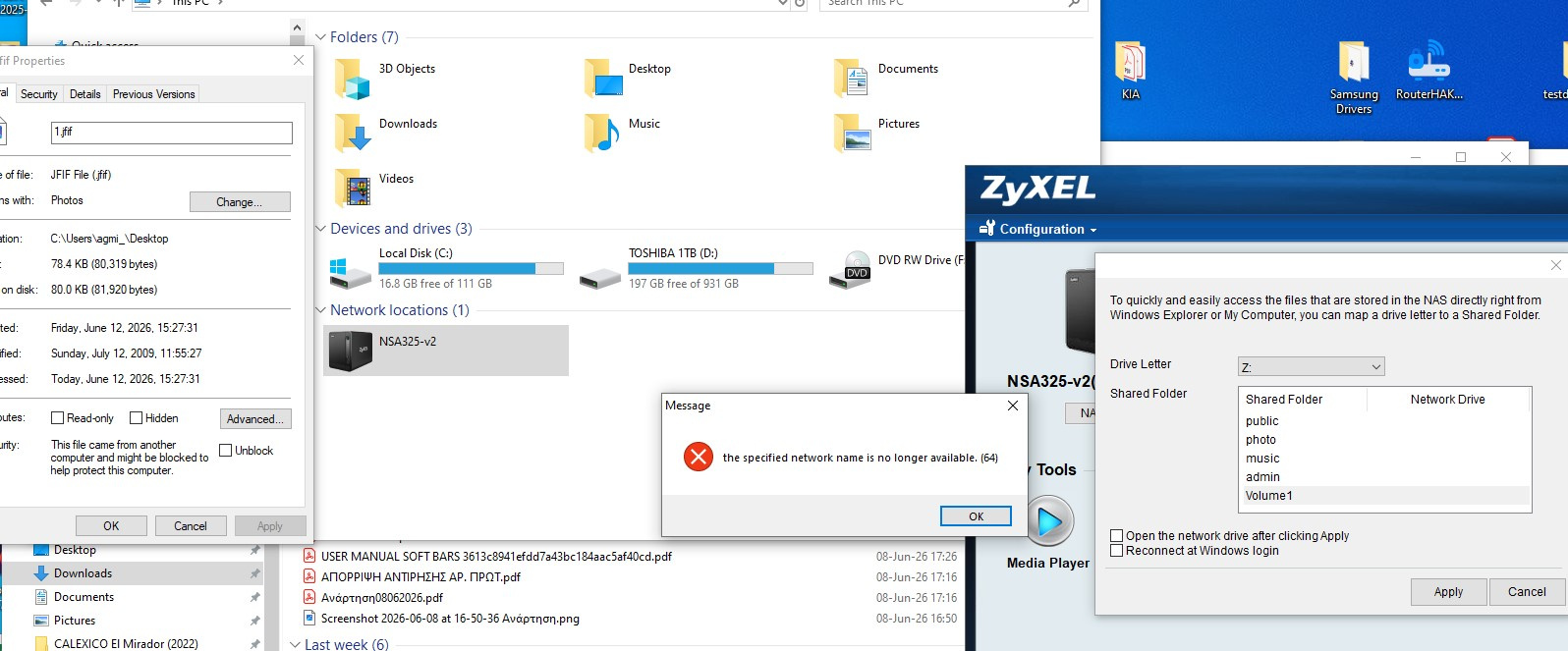

    Thanks 4 the quick reply, after copying a pic on the desktop, I also noticed that the extension remains the same. ABC.jpg is named to ABC.jfif. As long as I dont see and access the Z drive I can't use a cmd to change all the image files back to jpg😕
    I read that jpg is jfif. As about the network drive shared folder etc etc dont have any clue how did they disappear!

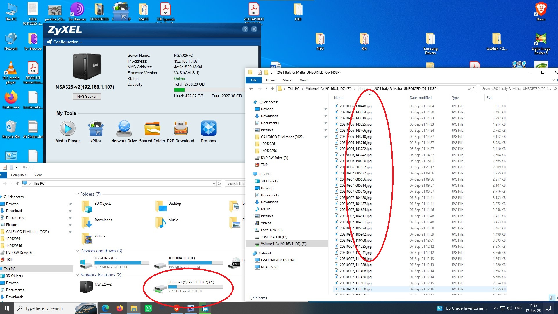

    Thanx a million, once enabling it, I can access my Z drive and all the image files are jpg instead of jfif; no need to batch convert them!
