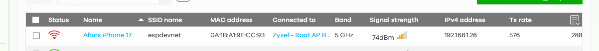

I have 2 x NWA50AX in smart mesh mode, Managed by Nebula, I have noticed that my iPhone 17 devices show as offline in Nebula after roaming between the 2 x AP's and never come back as "online".
Event log shows that roaming is taking place, but the iphone17's never show as "Online" again. The iphones are still working normally. I have 2 x SSID's and no other wifi AP, only the 2 x NWA50AX devices, firmware and ios are at the latest level for the AP's and the iPhones.
iPhones have FIXED private Wi-Fi address. Data services have been turned off during testing of this issue. Internet speed for the iPhones is unaffected, Im getting the max download speed that my broadband provider has allocated ( BT - VDSL ).
Turning off/on wifi on the iPhone devices fixes the issue for a short while.
Smart Steering is enabled, all Advanced settings are at default.
Apart from the iPhones not being displayed in the Nebula Cloud, nothing else appears affected! These are the only devices that are exhibiting this issue, I have a mix of iPad's , , smart plugs and Alexa and IOT devices.

Hi Melen, yes the problem is still occurring, I have enabled admin access for you.
Client (iphone 17) roams from root AP to Mesh Repeater which shows in the clients event log, the current stations live tool for the root AP shows the client still connected to the root AP, after 15 mins or so the client is no longer present on the root AP, the client event log states its roamed to the repeater AP, however the client doesn't show up on the repeater AP current stations live tool, or any client list/display. It only shows as offline on the root AP, client display.
I have the exact same issue with another iPhone 17 as well.
Best Regards
Alan
Org Name: Alan_Twigg_Zyxel , iphone 17 mac: 0A:1B:A1:9E:CC:93
