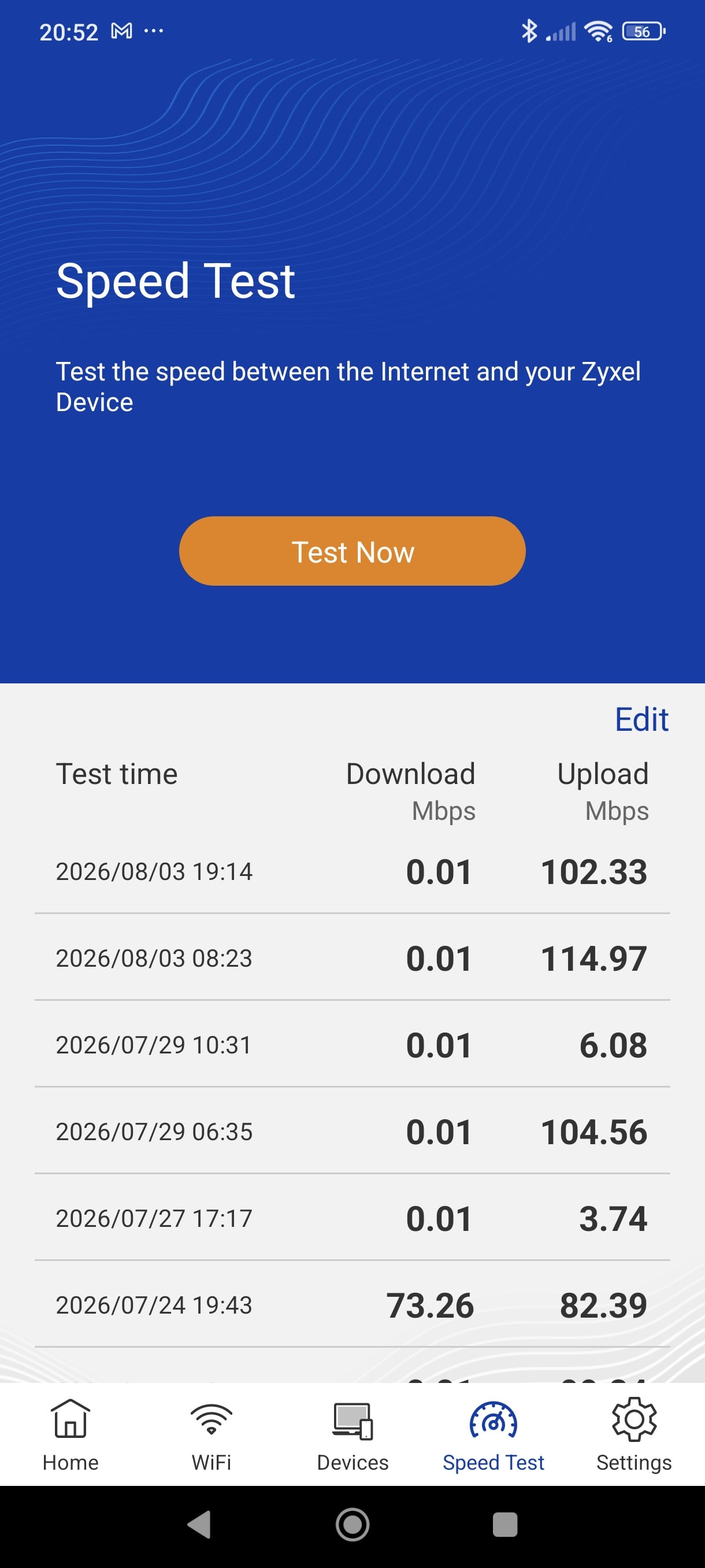

    Hi, sorry to hijack the thread, but I'm experiencing exactly the same issue.
    Zyxel modem speedtest showing 0.1 download irrespective of connection speed.
    Run speedtest on a device behind the modem (and router) and the download speed relates closer to the connection.
    First experience of this was 13/06
  • Zyxel_Judy
    Zyxel_Judy Posts: 2,629 image  Zyxel Employee
    Hi @Maskelyne ,
    Thank you for your detail info and screenshot.
    We're investigating the symptom you reported and will reply to you if there is any update.
    Zyxel_Judy
