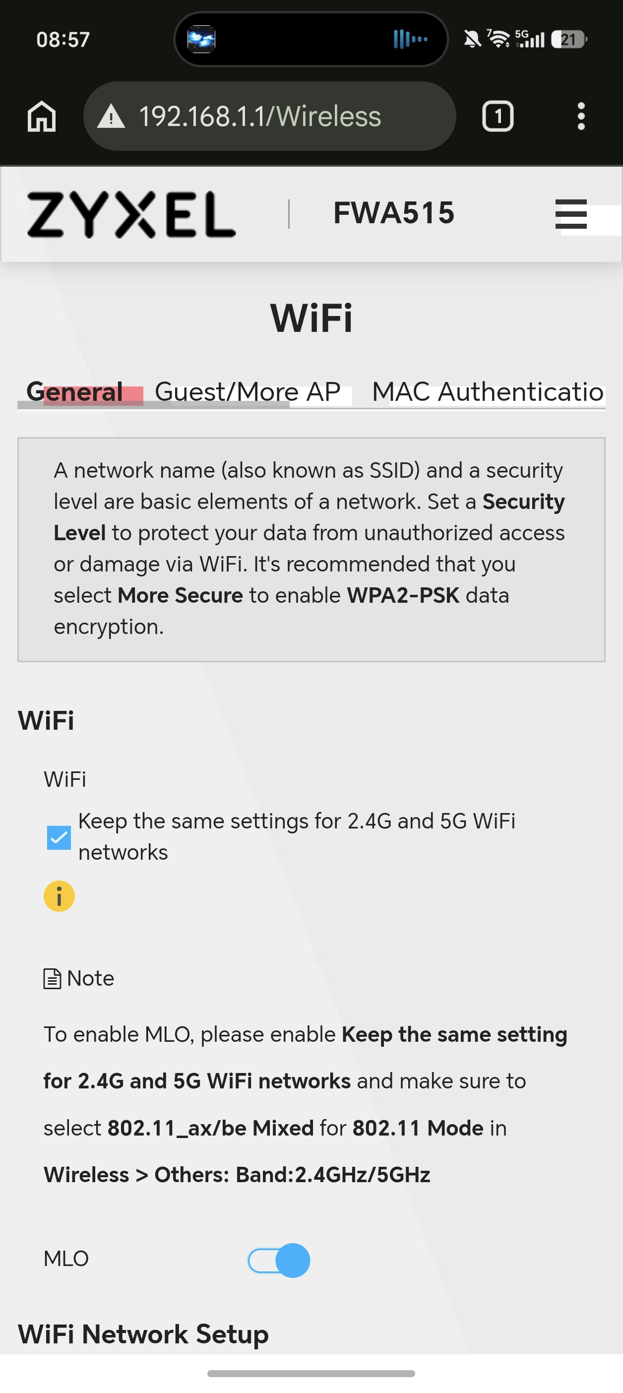

I noticed that MLO is very buggy and constantly does handshakes with my MLO clients. They lose connection and most of the time, they show "No internet" - I've checked logs and saw that 7990@ERROR.PROTO, rai0, Peer_Vendor_Spec_Action(): frame len check error occurs very often.. also saw logs like "disconnected from 6GHz radio" although the router doesn't even support 6GHz. Well, technically, it should but it's probably just disabled.
All MLO clients I use are affected. Some devices stay connected for a long time, some of them frequently disconnect.

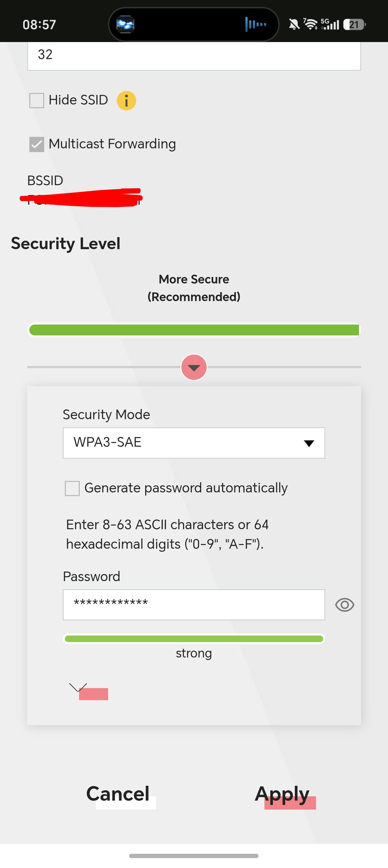

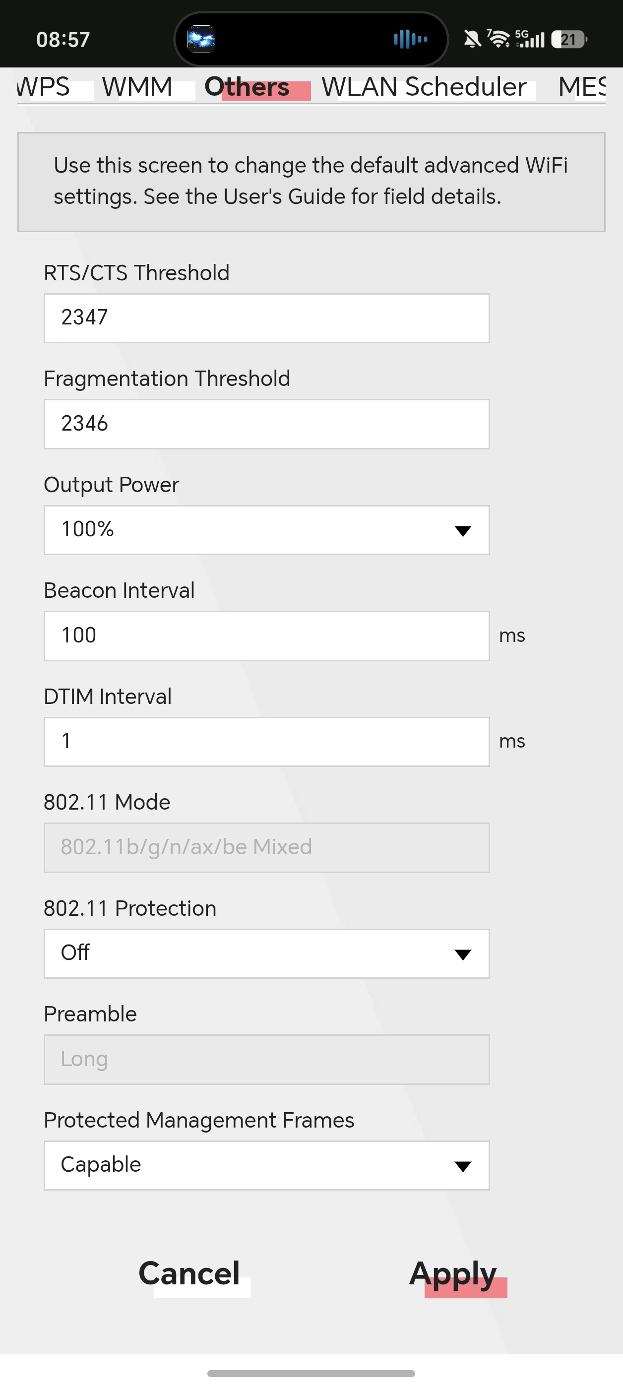

Happens all the time.. group key handshake failed (RSN) after 4 tries. Doesn't matter if I use WPA2/WPA3 mixed SAE, WPA2 only, or WPA3 only, PMF disabled/capable/requires doesn't help too. I've tested it in EVERY possible way you could think of, incl. changing radio settings even down to n-only mode. Nothing helps. That's why I think it's a bug.

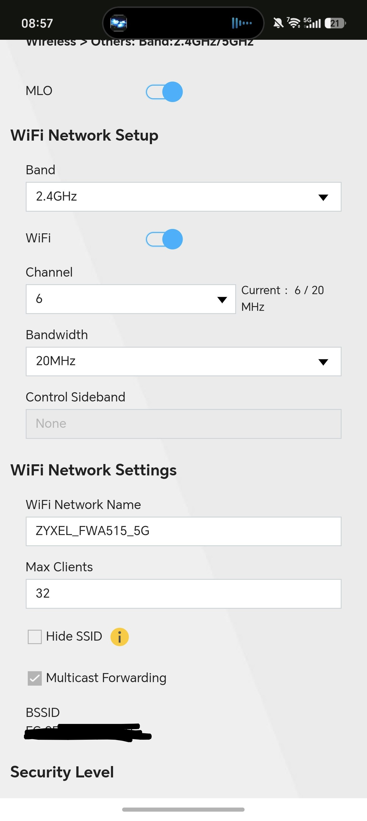

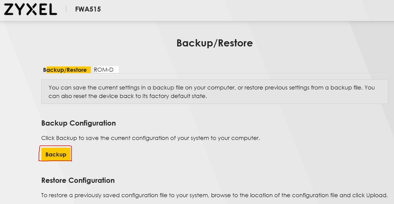

In addition, as some information is not visible in the screenshot provided, could you please back up the device configuration and share it with us via PM?
Additionally, does the disconnection occur regardless of distance/signal strength, or only when the affected client is farther from the device?

Hi, I've tried V2.00 ACJT (NR5307 ZCOM based device) and V1.70 (official FWA515) - the Zyxel FWA515 definitely has issues with WiFi management, BUT only with some devices. I was wrong. My Windows laptop with the Killer 1750x does NOT have that problem. But all other listed devices lose connection.
And yes, signal strength is always excellent. 5G signal is also great, I've never had such good 5G signal parameters on any other 5G FWA I've tested.
My Ecovacs X11 PRO OMNI, which apparently uses a FN-Link WiFi module, also loses connection with the same GTK-key handshake failure. AX-only mode, ac-only mode, n-only mode didn't help too. I've tried every single WiFi config we could think of.
I'm 100% sure that this bug is related to MediaTek MT7990 firmware as I've had the same issue on a ZTE G5 Ultra MC8512 with the same chipset (MediaTek T830 5G SoC, MT7990 WiFi module) - and no, it's not related to my devices as they work well with other routers except, Zyxel FWA515 and ZTE MC8512 excluded.
Thank you.
Config is sent via PM.

Uploaded file as .rar - sent via PM.
