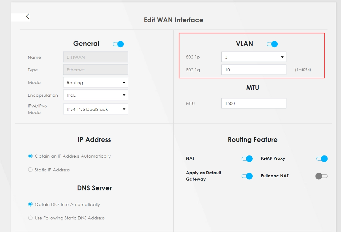

Hi @Zyxel_Tina,
Thank you.
Ok, I configure the VLAN on the FWA515, but how I can use the PPPoE? I see that the encapsulation is selected as IPoE, but I need the PPPoE over VLAN 835 to initialize an internet connection.
If the FWA515 support the PPPoE over VLAN, I can use the ETHWAN to establish the internet connection over WAN, and then I can use the failover on 5G; all this can be managed directly on the FWA515 and in this way it can manage also the internet connection.
In this way, I can configure a single port on the flex 500H because the connection management is directly into the FWA.
Can I see under the dropdown menu "Encapsulation" what are the other choice?
There is a demo website for some FWA?Thank you

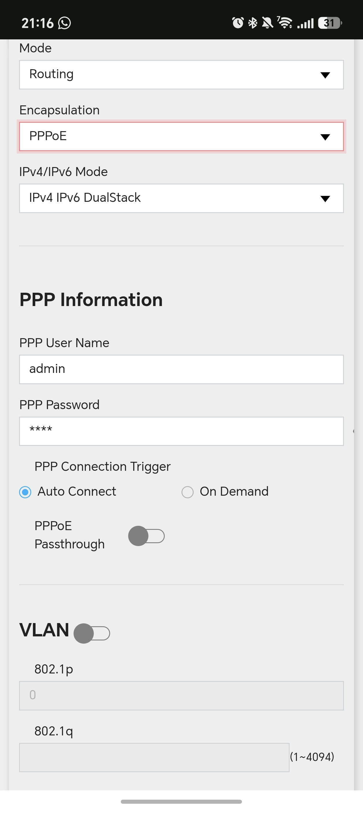

Hi @Zyxel_Tina,
I asked to a user to share the ETHWAN configuration of the FWA515
So:
- Seems there is a possibility to set the encapsulation as PPPoE
- It's possible then to insert username and password
- It's possible also to specify a VLAN
My actual configuration is:
ONT Fiber ETH —> USG FLEX 500H P1 (configured as PPPoE over VLAN 835)To avoid using another firewall port, I would now like to configure the new infrastructure as follows:
- ONT Fiber ETH --> FWA515 ETHWAN (PPPoE Passthrough)
- FWA515 LAN --> USG FLEX 500H P1 (still configured as an external interface but without DHCP)
At this point, the firewall no longer performs failover/backup between ports P1 and P2; instead, is the FWA itself that acts as a backup, pass to the LAN port the fiber connection (if present), or the 5G cellular network if PPPoE fails for some reason.
Could this work? How can I configure port P1 on the firewall to receive the IP from the uplink?
Thank you
