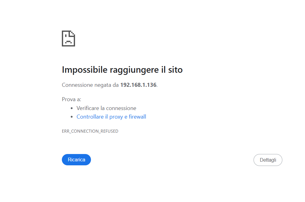

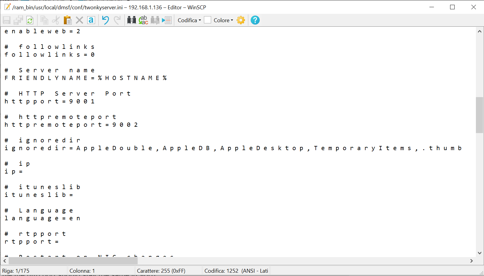

  • Neo
    Neo Posts: 4 image  Freshman Member
    First Comment First Anniversary
    edited July 19
    I have the same problem with my nas326
    I think that after some sudden power cuts the entire twonky program was corrupted, I can no longer find any trace of it!
    Http server port is already 9001
    what could have happened?
    Thank you all !!!
