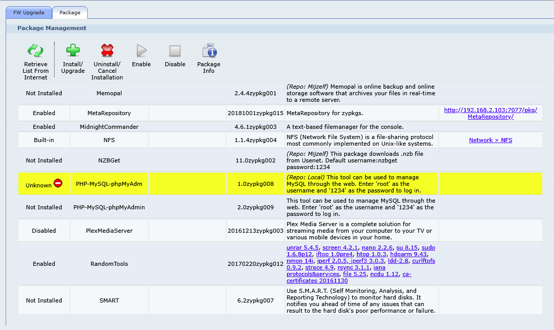

    …update
    actually the situation has been changed. Finally I've successfully(?) installed the PHPMyAdmin 1.0zypkg008 version. The result is here:
    the state of the installed package is 'Unknown'. Moreover, the WEB service is not working as expected, the php scripts are visualised as txt .
    Thnx for any help
  • Mijzelf
    Mijzelf Posts: 3,038 image  Guru Member
    The box runs Apache, and in Apache php is enabled with a dynamic library. Apparently the provided library in PHP-MySQL-phpMyAdmin is not compatible with the running Apache. In which case the php scripts cannot be executed.
    Try the oldest PHP-MySQL-phpMyAdmin package.
