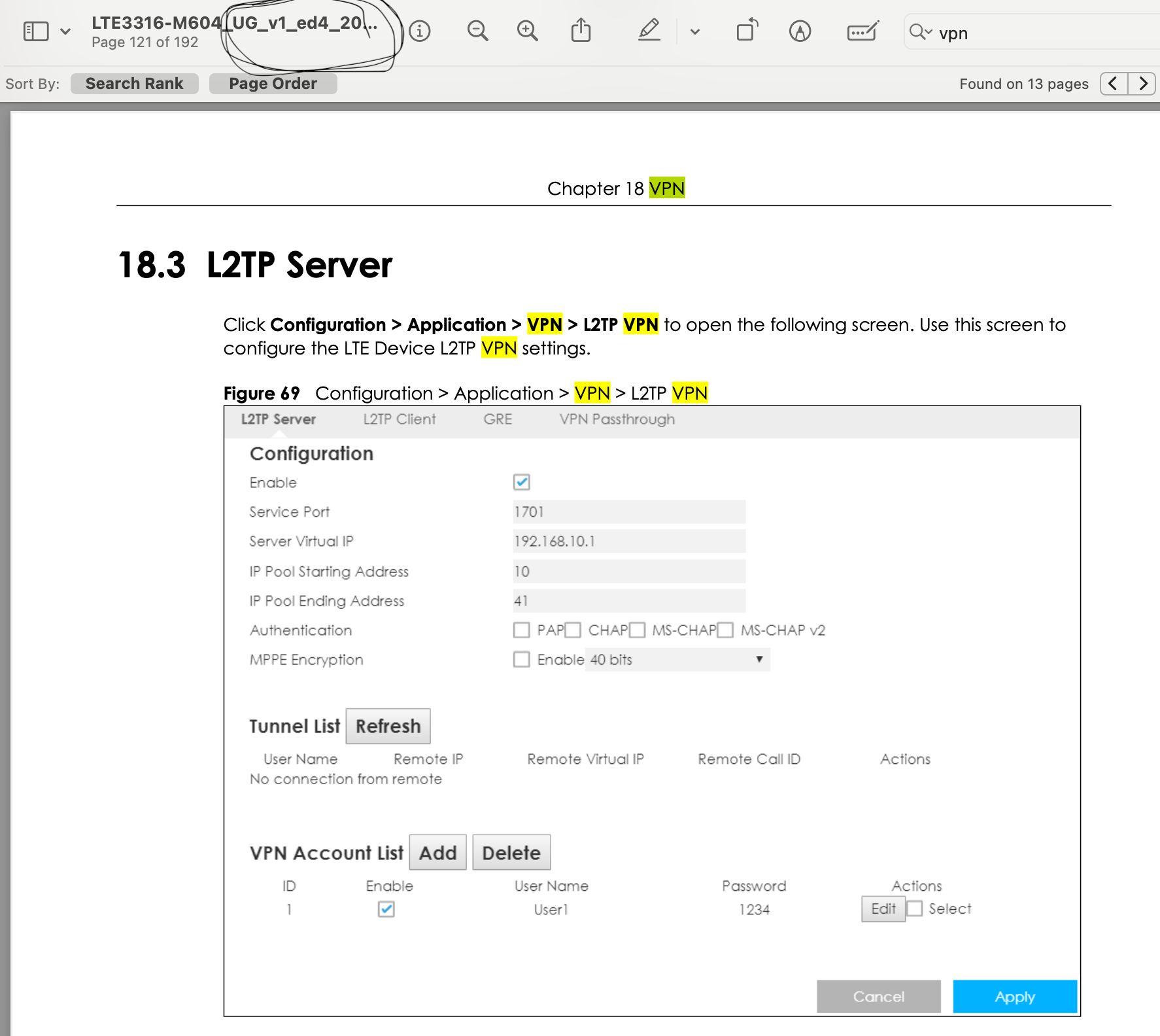

LTE3316-M604 handbook states:
Menu Configuration > Application > VPN > L2TP VPN for the Server and Configuration > Application>
VPN > L2TP Client for the client. [in standalone mode].You have the latest FW installed and you are sure it is a LTE3316-M604?

There is some information in the user guide, see below extract, available to download at https://www.zyxel.com/uk/en-gb/support/download?model=lte3316-m604 as a ZIP file with 2 PDFs in it.

Thanks, however the user guide for V1 has that but my hardware is version 2.. if you look at the user guide for that suddenly VPN isn't an option. Its like they have upgraded the firmware and the ability to use a VPN has been removed.

I have looked at the release note for the firmware, see below extract, and it does not say that the VPN feature has been removed. It also says that the firmware is generic for the LTE3316-m604
The latest firmware does resolve a security vulnerability too.
It is v1 of the user guide, but I think that it applies to all the hardware. It does not say that it is hardware version specific for the LTE3316-m604.
Are the options for VPN definitely missing under the Configuration menu and Application under Configuration?

The screen shot you have above is for VERSION1 The menu system in VERSION 2 is completely different and there isn't a "configuration menu" I have attached a screen shot of the user guide you are using and at the top you can see it says V 1
0 -

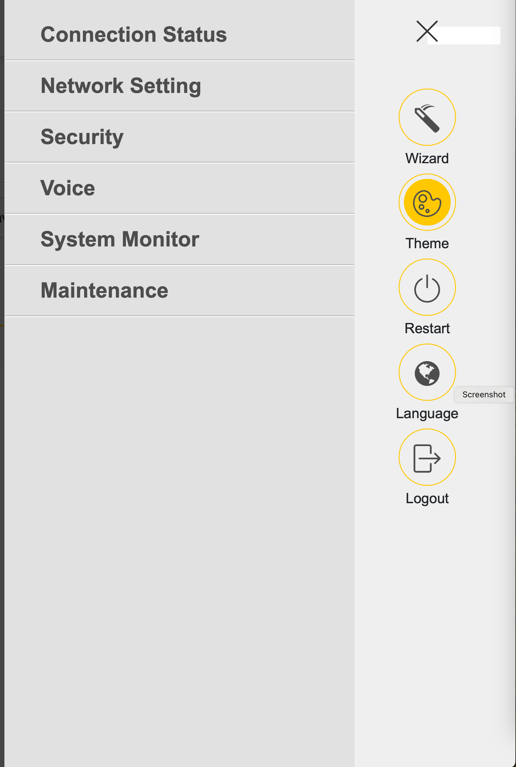

The menu system I have is VER 2 and here is a screen shot of what is available
0 -
In all of those menus (and in the V2 user guide) there is NO mention of VPN
