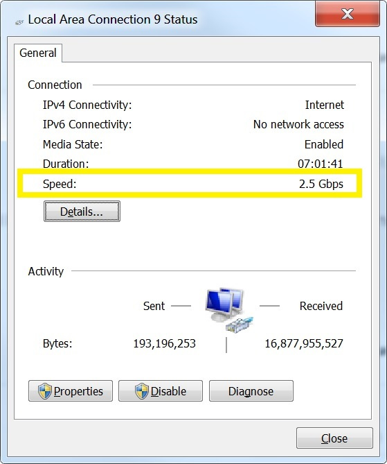

  • Lefty_Insider
    Lefty_Insider Posts: 28 image  Freshman Member
    2.5G from the WAN modem to the 2.5G switch. 2.5G from the switch to the 2.5G router WAN port. 2.5G from the switch to another 2.5G switch, to 2.5G clients. Don't see what you are talking about and neither does my computer. See attached
  • PeterUK
    PeterUK Posts: 4,502 image  Guru Member
    Link speed will be 2.5Gb even if you connect modem to router WAN because you go from client to 2.5Gb switch to 1Gb LAN on router to WAN 2.5Gb to modem.
    Just because you have the modem to switch will not mean you can go faster then 1Gb because client to 2.5Gb switch WILL go from switch to LAN 1Gb LAN on router then WAN 2.5Gb to modem
