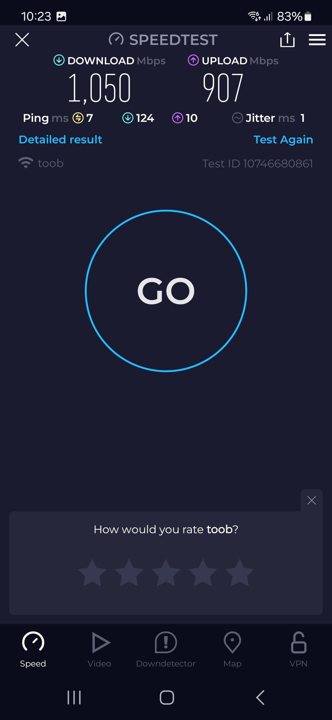

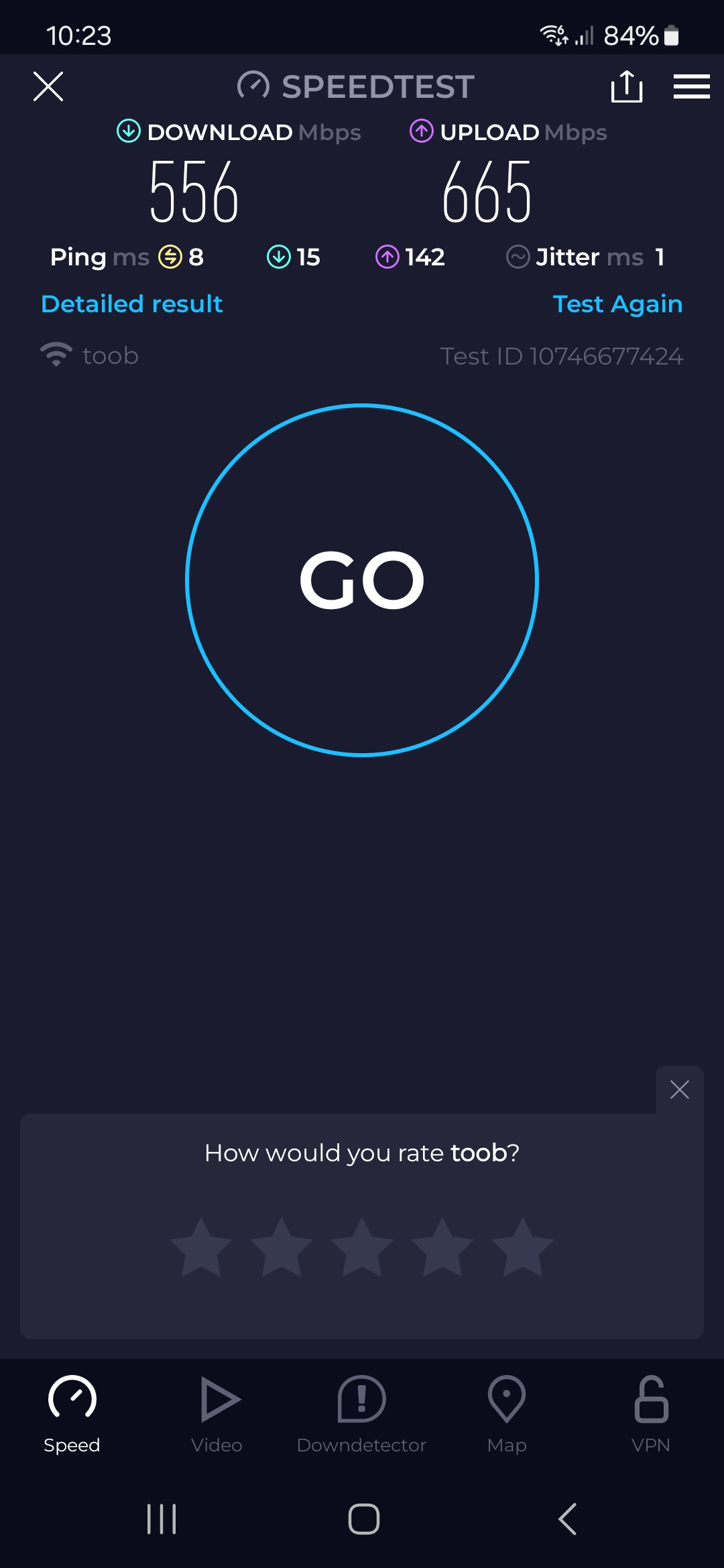

    Hi, as requested two screenshots of speed tests done within 2 mins of each other, each was using the same server. The one showing 1.05Mb/s download was at the router, the other at the kitchen AP.
