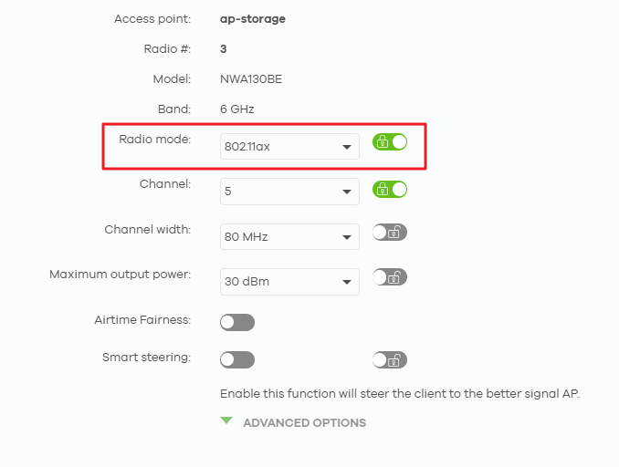

    Thanks for the privilege. I found that your AP's radio setting seems strange at 6 GHz.
    The radio mode is 802.11ax. Could you change to "auto" or "802.11be" and check again?
    Zyxel Melen

    chatziko Posts: 7  Freshman Member
    Thanks for the suggestion, unfortunately it made no difference.
