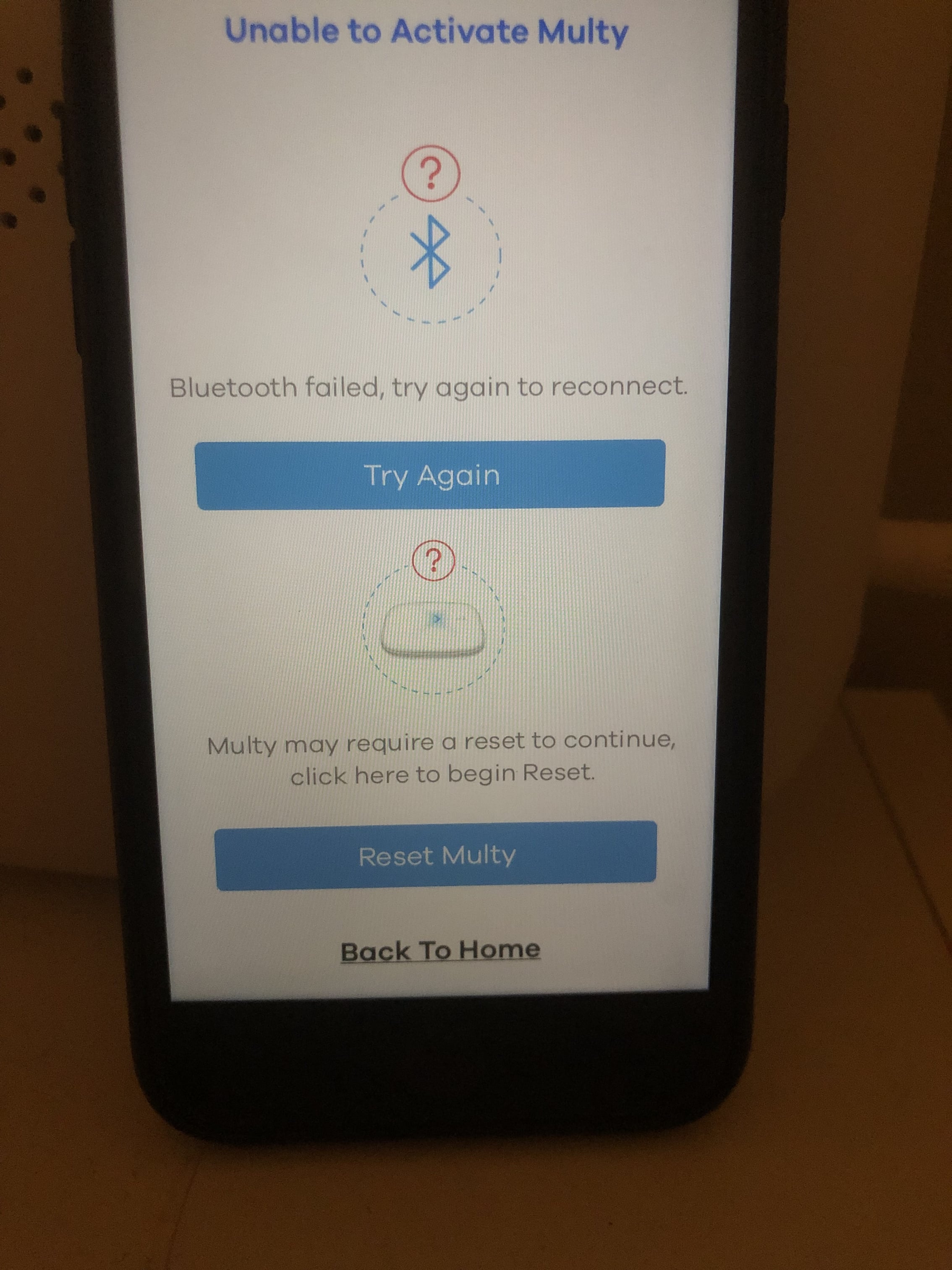

  • Helene
    Helene Posts: 5 image  Freshman Member
    Hi Judy, thanks for responding and helping move this forward!
    The model is a Multy X WSQ50 (not M1). Attaching clip of the installation process. The unit is already previously installed, but will not "register" to the (newly installed) app, so I've tried both installing and reseting.
    The reset gets me as far as choosing network name(s) for 2.4 and 5G, and password, but in the next step the app can not connect to Bluetooth = not yield a fully finalised installation. Both options to install/reset come up again. Do you need video on the reset process as well?
    Feedback sending issue: I'm not getting passed the installation process itself - it is the first and only page I see as I open the app and try install/reset. There is no main menu made available, or any other functions (settings, install the other unit, etc) that are part of the other functions in the app for the units.
    Could not upload video, but sending WeTransfer (link available for 3 days)
    Thanks again! /Helene

  • Helene
    Dear @Zyxel_Judy thanks again for sticking it out with me, I tried replicating your suggested solution as below. I do think a remote session would be a good next step if that is possible?
    As per your suggested recommendations 1-3:
    1. I am not able to verify this, due to the core issue still unresolved. Will it help if I share serial number of FCCID?
    2. I can confirm the latest app version is 2.6.1 (no more digits are apparent in app store and if the complete version details are available in the app interface, I still cant access it due to primary issue)
    3. Confirming that Bluetooth on phone is on (and other units in the same space are set to off during Multy app use process)
    My process this time: log in; "install Multy screen"; choosing Multy X, waiting 4 minutes, unplugging and replugging network and power, waiting for green blinking:
    1. When reaching the step in the app that prompts the Multy should be blinking blue, it does not. It blinks green (due to already installed) and then just hits solid green, no blinking.
    2. The app then continues to try to establish wifi (but not as per your screen shots - no options of wifi pops up, it just searches anonymously) and cannot establish/find wifi.
    3. The app it prompts me to A. Try again or B. Reset Multy.
    4. I here waited 4-6 minutes (as you described) - no wifi set up as per your screen shot appear.
    *Do let me know if there is anything else I'm supposed to do differently before getting to this step.
    5. I then tried to reset using a paper clip again to see if other options pop up.
    6. The app states "when the light goes from red to off it is ready for reboot".
    7. I pressed OK here, though the light goes from (fast blinking) red to blinking green again (not off).
    8. The app prompts to wait 3 minutes while waiting to reboot, and says it "connected successfully. You can now proceed to connect to your wifi network".
    9. I choose my new own wifi names (separate 2.4 and 5G) and password.
    10. App prompts: "Connecting to network", waiting 4 minutes
    11. App prompts "Unable to activate Multy. Bluetooth failed, try again to reconnect. I try again and wait for 4 minutes. App dialogue prompts "connection failed. OK." I press OK. I try again.
    This time I wait for the red to blink fast then press ok (next step) in the app. While waiting for 3 minutes to reboot the light on the Multy is blinking green (not red anymore and never off) and restarts process from step 8-10. Dialogue box promts "Setting Error: Confirm". I press confirm. Back to unable to connect Multy.
    So the wifi again works for my other units, but I'm not able to use and activate the 2 Multy X units as a mesh, which I need.
