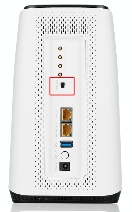

OK, so I tested switching the Ext Ant switch, without any external antenna attached. My theory was that the router would lose the 5G connection but fall back to 4G, still using the internal antennae.
However, that's wrong. The router lost its connection entirely. So switching the Ext Ant switch appears to disable the internal antennae and rely entirely on the external.
So I guess an external antenna that works with 5G but not 4G would not be able to provide 5G-NSA.

Hi @Dr_Elmer
May I know if you have switch INT/EXT antenna switch to EXT?
If so, may I know if the directional antenna is fixed? Where do you place the directional antenna? Outdoor or indoor?
