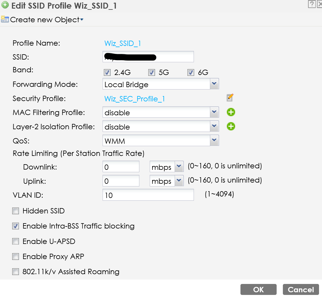

    The AP configuration is this:
    The only things that I've disabled is the Proxy ARP as suggested by PeterUK, but the Intra-BSS Traffic Blocking is already enabled.
    But in this configuration, seems not working as expected.
    Thank you

    Hi @Maverick87
    So, is this the VLAN you mentioned in previous comment? Are the clients all connect to this SSID? If not, you still need to set ACL on the switch to block the traffic. The Intra-BSS Traffic Blocking only blocks the clients connecting to this SSID. If the clients is in AP's uplink, this feature will not block it.
