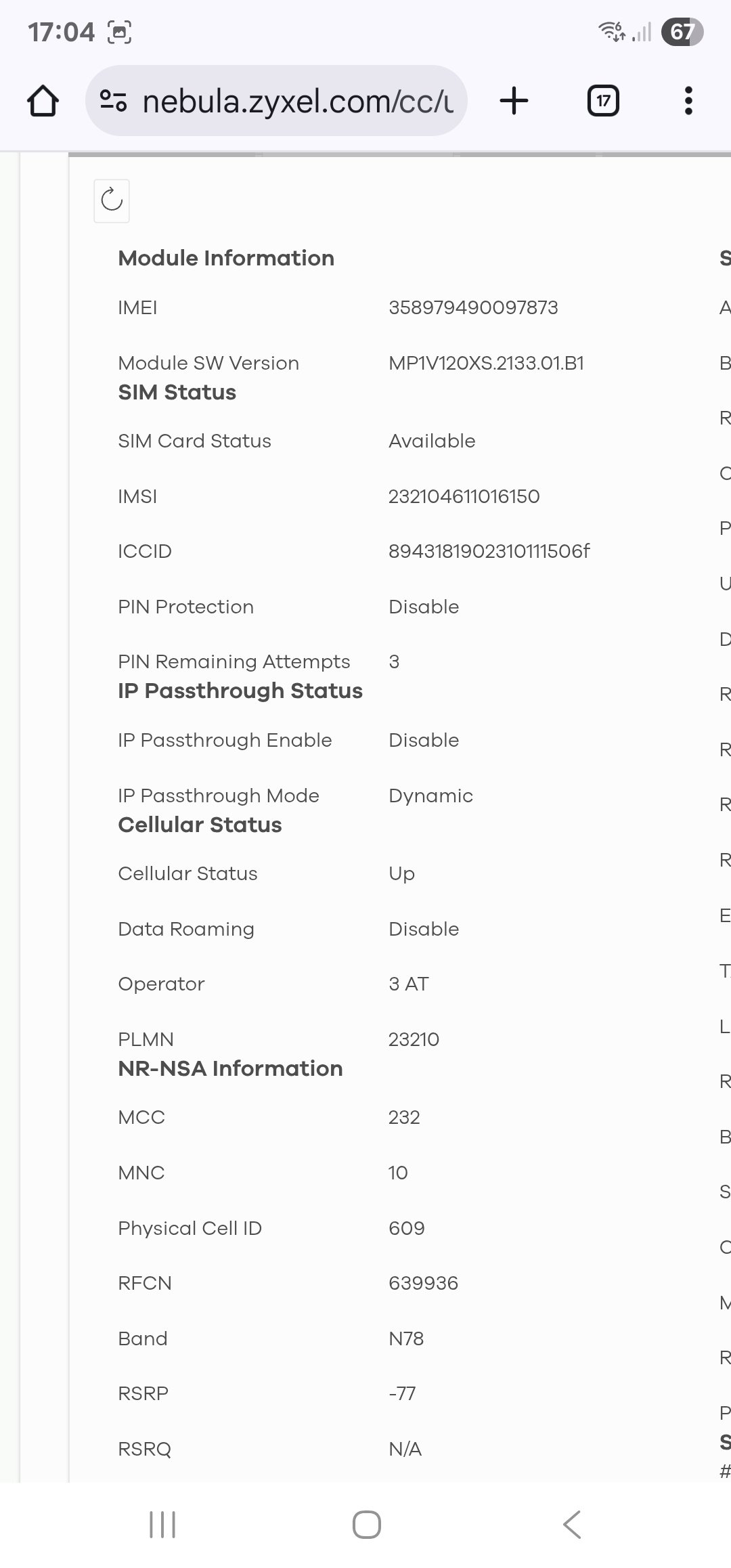

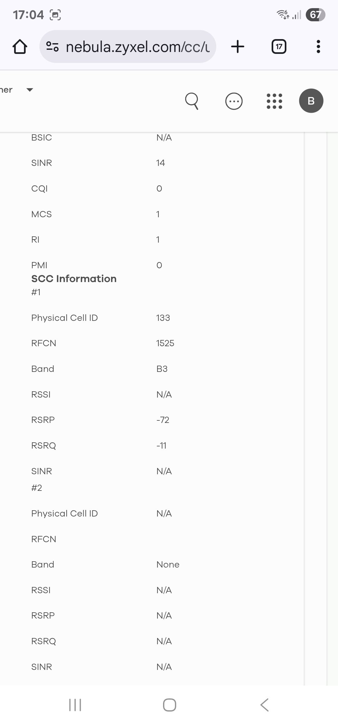

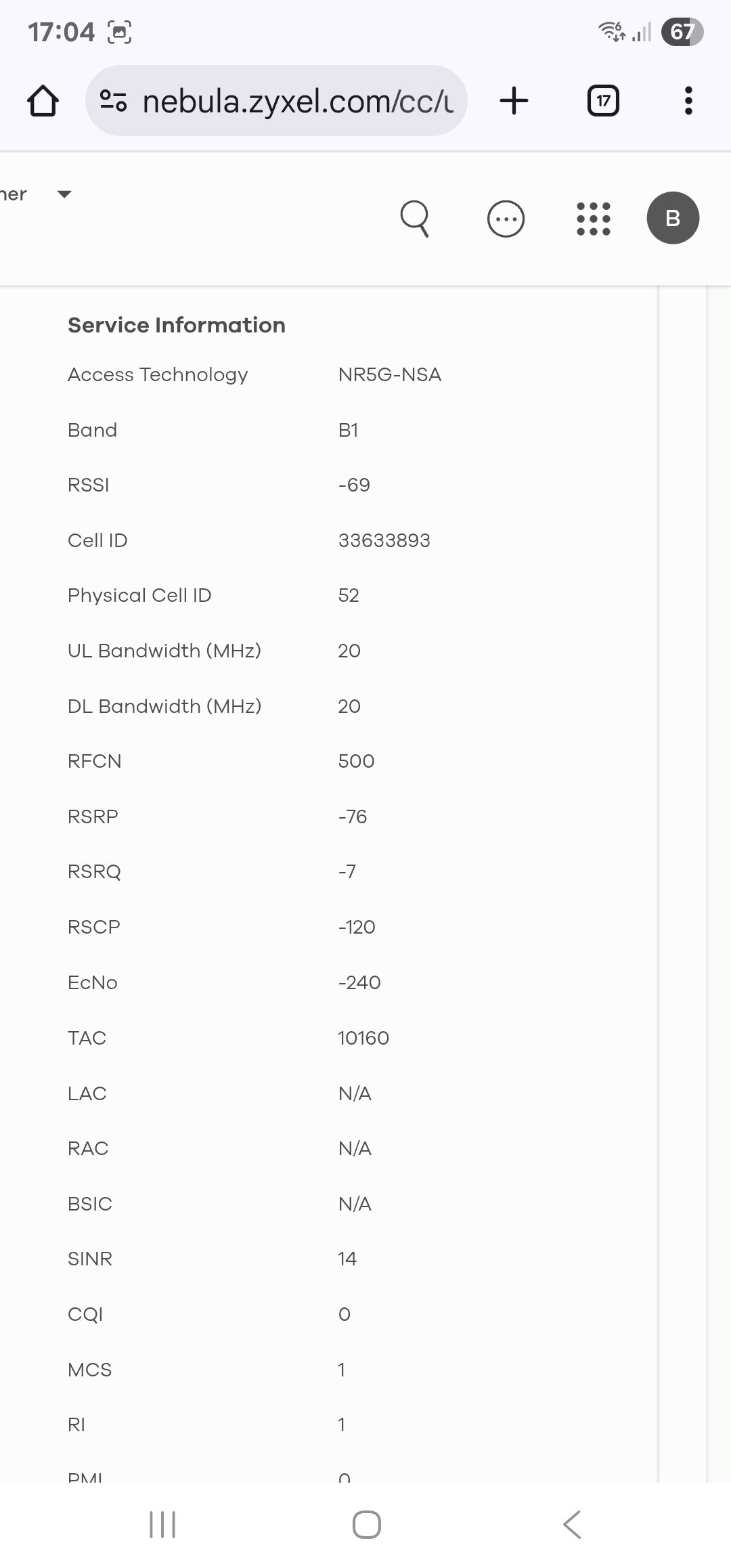

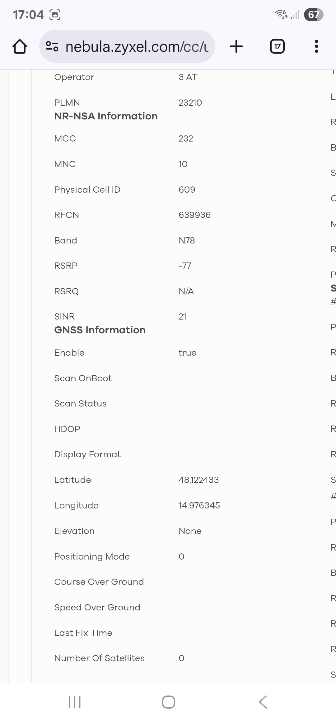

    Thanks for the information. So, the signal strength is also good? Could you please help to
    1. Capture a screenshot for page Cellular info. We want to confirm the rest of Cellular info.

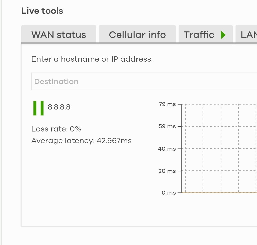

    2. To identify the LAN disconnection issue. Please check if you can ping
      1. The Internet, 8.8.8.8 or etc.
      2. The FWA710's lan IP.
    Thanks!
    Zyxel Melen

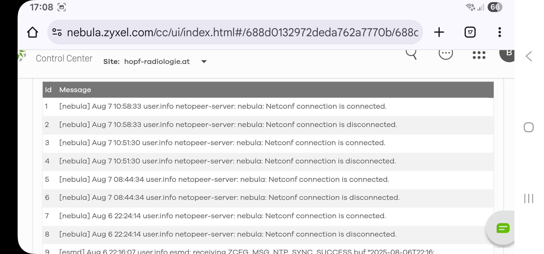

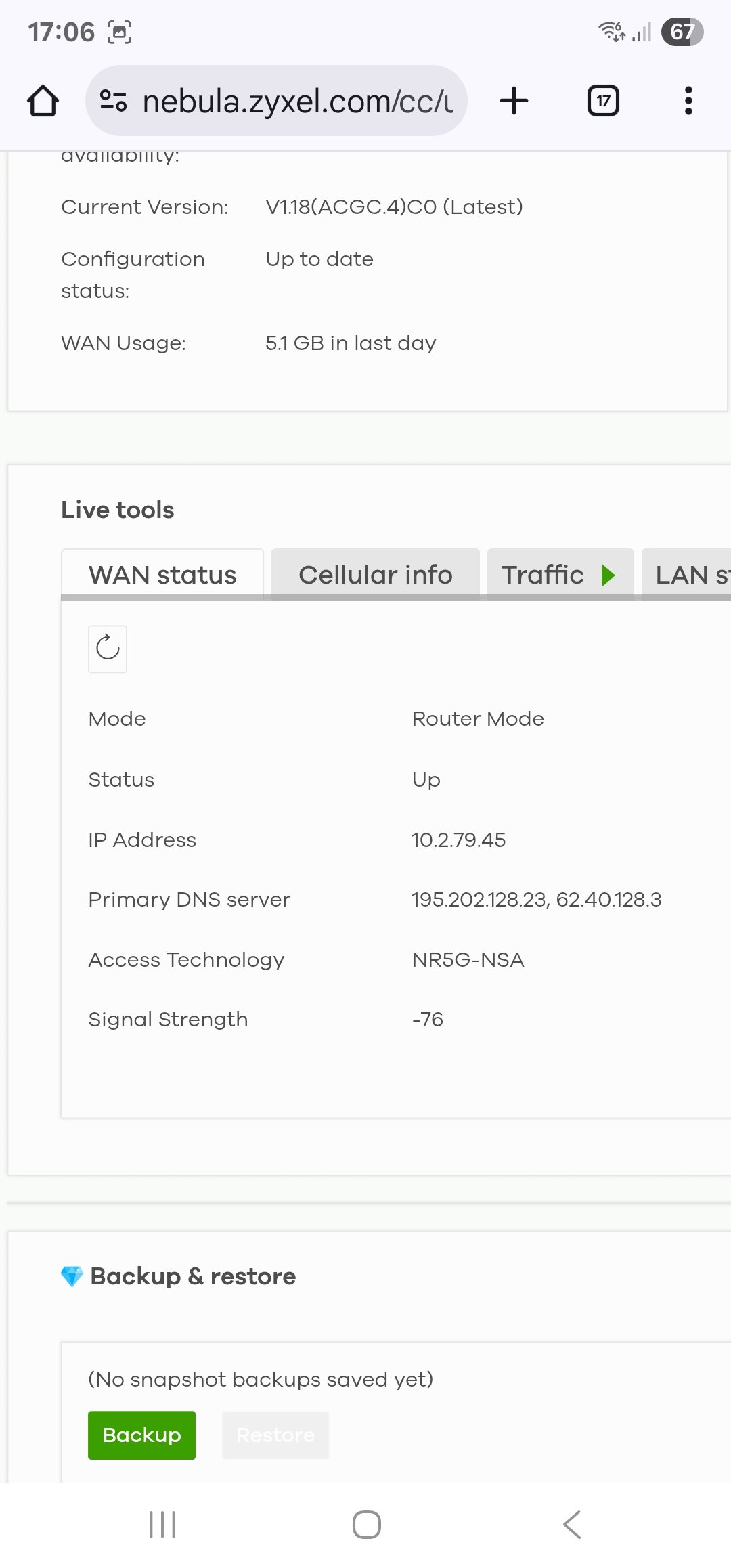

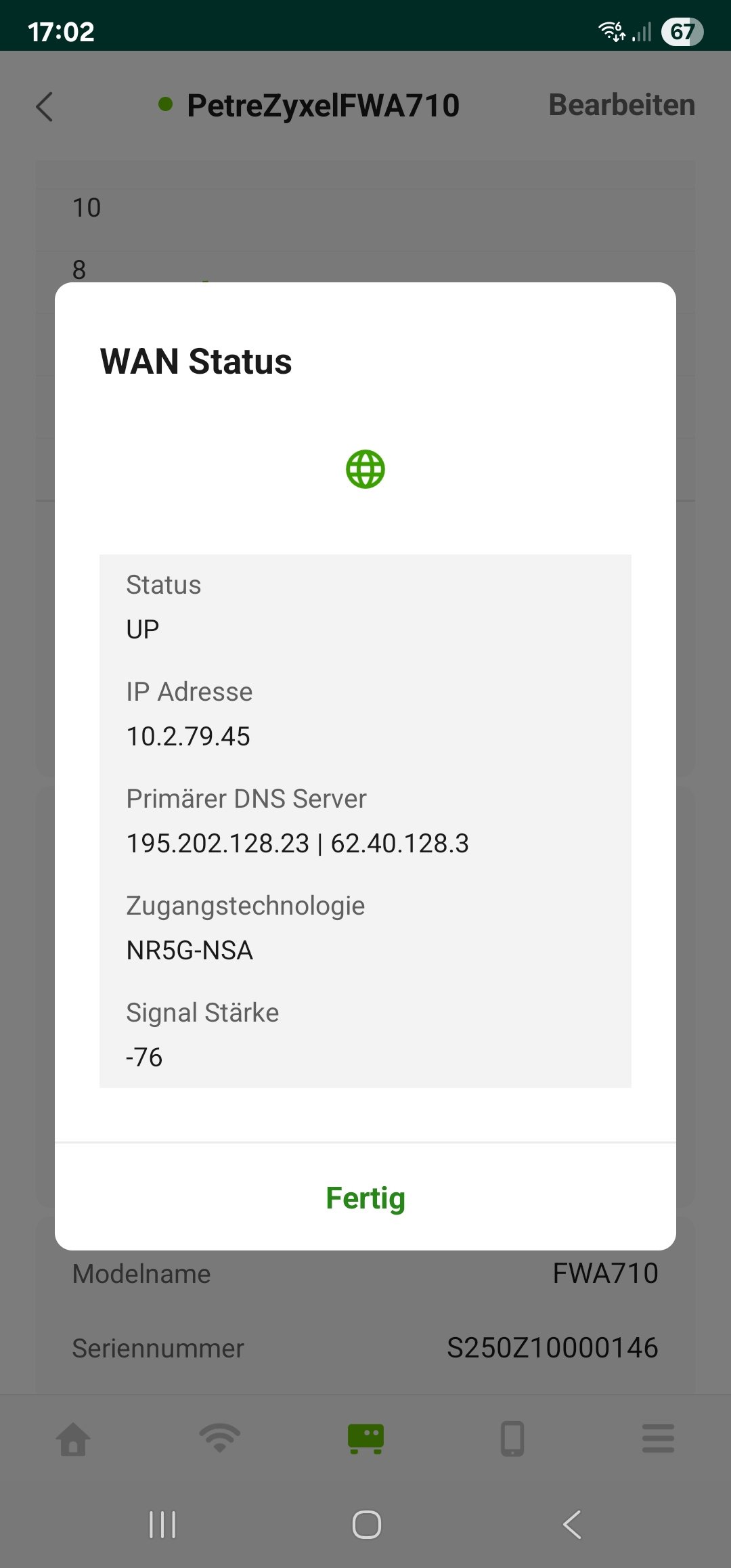

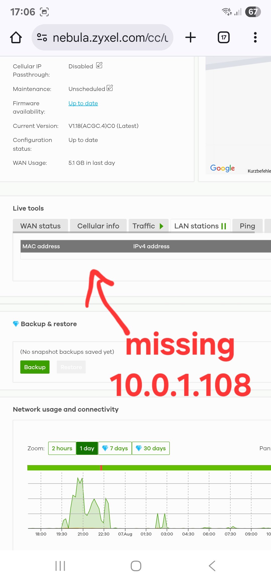

  • mrtvu
    mrtvu Posts: 8
    First Comment
    image  Freshman Member
    These screenshots I have take during the LAN failure before I rebooted the Zyxel.
    1000031852.jpg 1000031850.jpg 1000031849.jpg 1000031847.jpg 1000031846.jpg 1000031845.jpg 1000031844.jpg 1000031843.jpg 1000031842.jpg 1000031841.jpg
