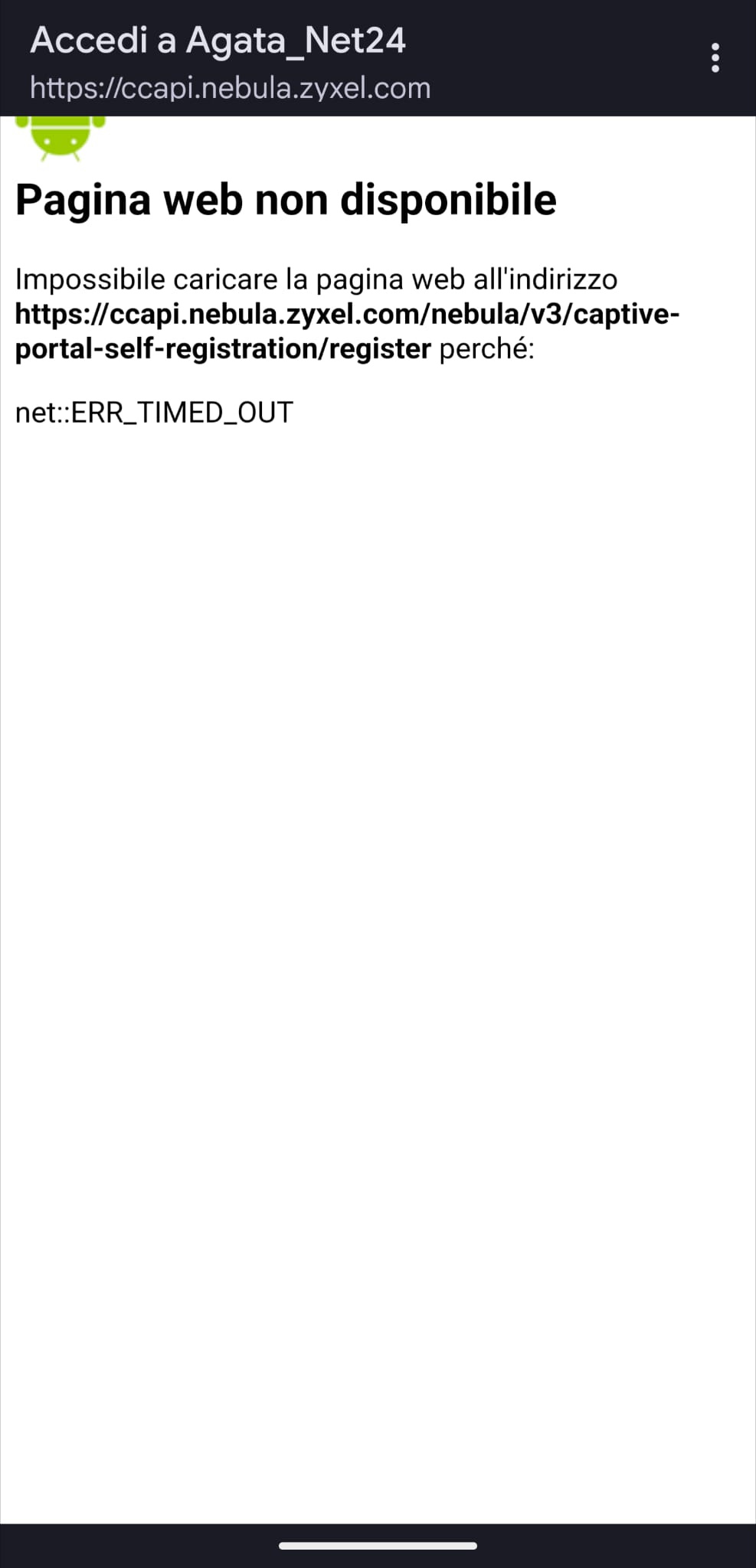

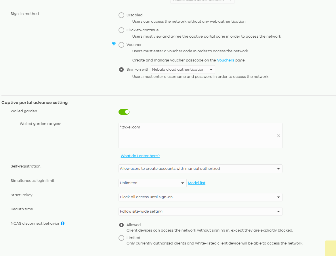

Hi,
i'm experimenting issues testing NCAS (Nebula Cloud authentication) with captive portal on a NWA90AX access point. When i connect to the network, which is password protected using WPA3, the system correctly addresses me to the NCAS login page. I choose to register a new user, fill in all the required fields and when i press ok i receive a timeout error after a while. I attach my captive portal config and a shot of the error shown on a mobile phone. I've opened a service ticket to Zyxel support 20 days ago but they can't solve my issue until now and now they disappeared… (ticket #501972)
Any help is appreciated, thanks!

    Hi @maxpontello,
    I did a quick local test with your configuration but I created the account with success. We will try to add our AP to your site to reproduce this issue. Also, could you help to check if your uplink router/firewall blocks https://ccapi.nebula.zyxel.com?
    Update:
    Add AP to your site also created the account with success. In addition, I found your firmware version is not latest, could you also try upgrade to latest firmware version?
