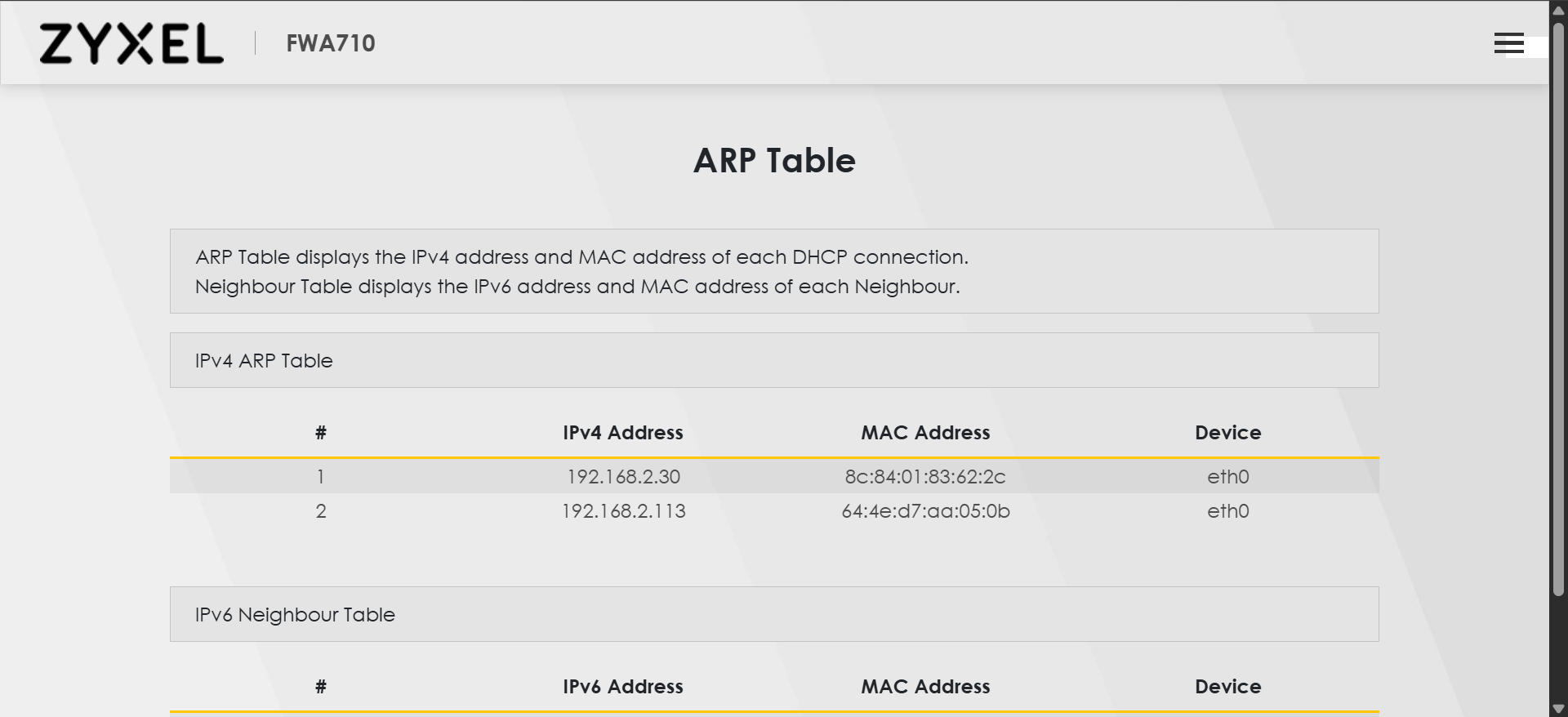

    Where do I see the list of DHCP leases, I want to set static IP for my AP's and some other devices. Where do I see this?
  • Zyxel_Melen
    Zyxel_Melen Posts: 4,895 image  Zyxel Employee
    Hi @bbfarm
    You may check the connectivity in the home page, or the Network monitor > ARP table to check the DHCP clients.

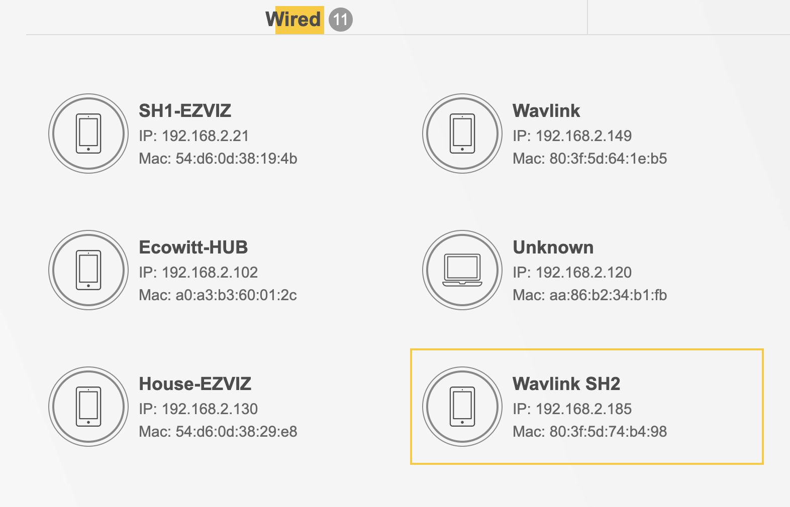

    Hello Melen,

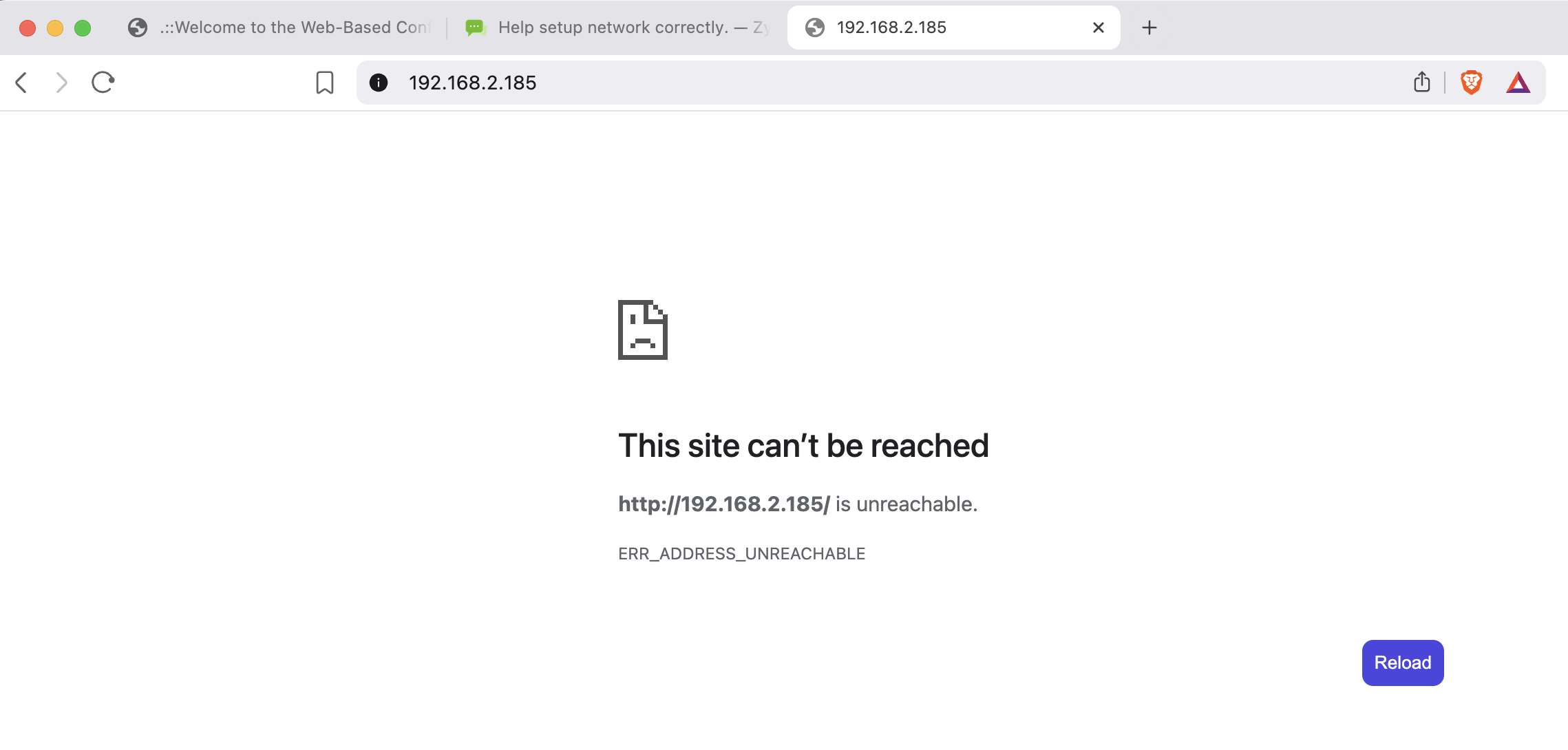

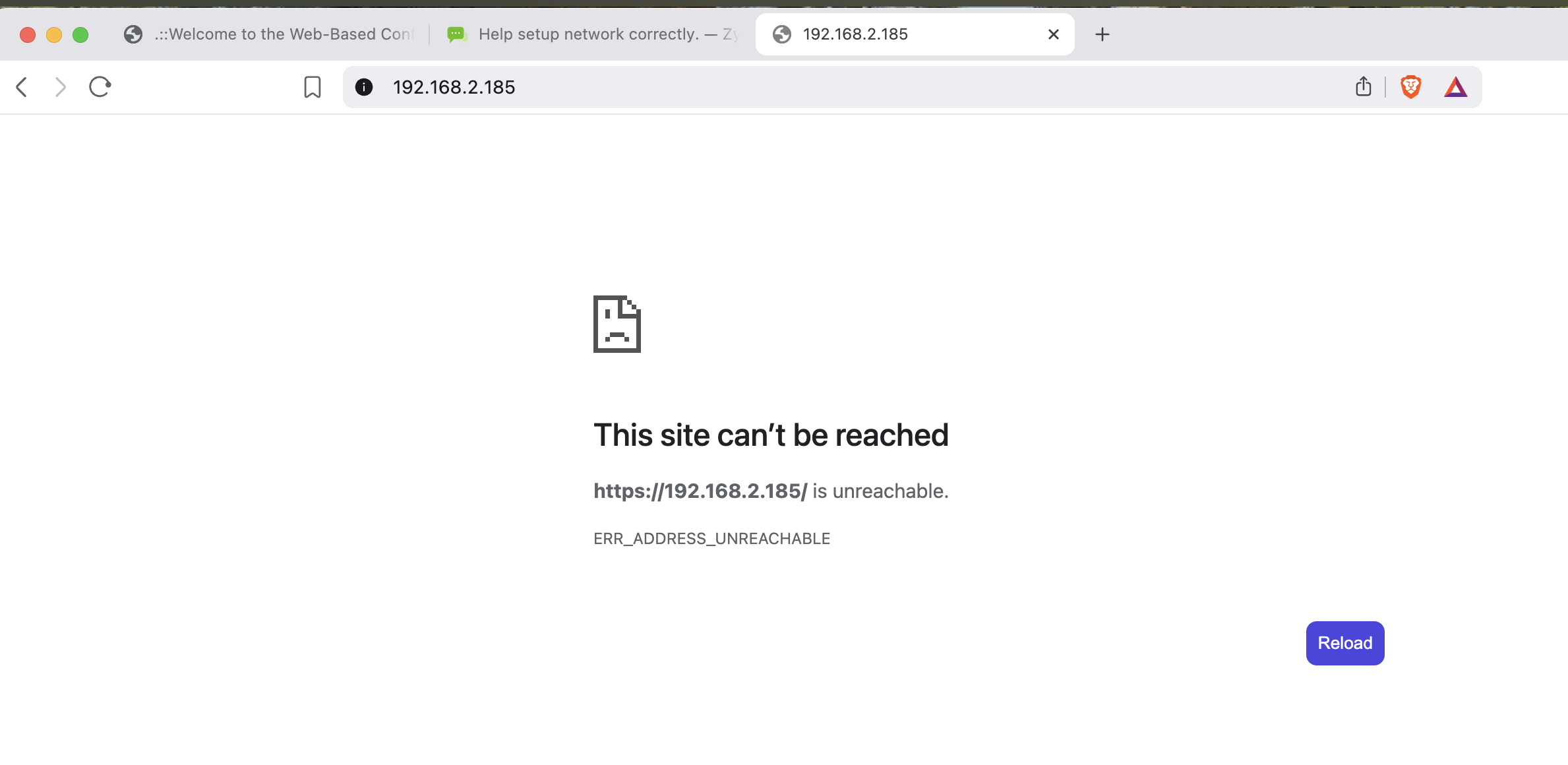

    Hope you are doing good. I have setup access point and I can see the lease on the Zyxel. And If i connect to a wifi of the access point internet works fine as well. However I want to make changes to some settings in the access point. I am unable to connect to the admin page of access point. How do i achieve this? Eg; the one highlighted in yellow below;
    As you see the ip addess is 192.168.2.185. If i try to put that ip in browser it says page unavailable.
    I tried both http and https. How do i access the admin page of my AP? Why are my devices not reachable with the ip address? I am on the same wifi as well of the AP.
  • Zyxel_Melen
    edited September 2025
    Hi @bbfarm
    I'm not sure if this AP's default AP mode is NAT mode or bridge mode. If is NAT mode, it might not allow you to access it from uplink. I suggest checking with the AP's vendor about this issue.
