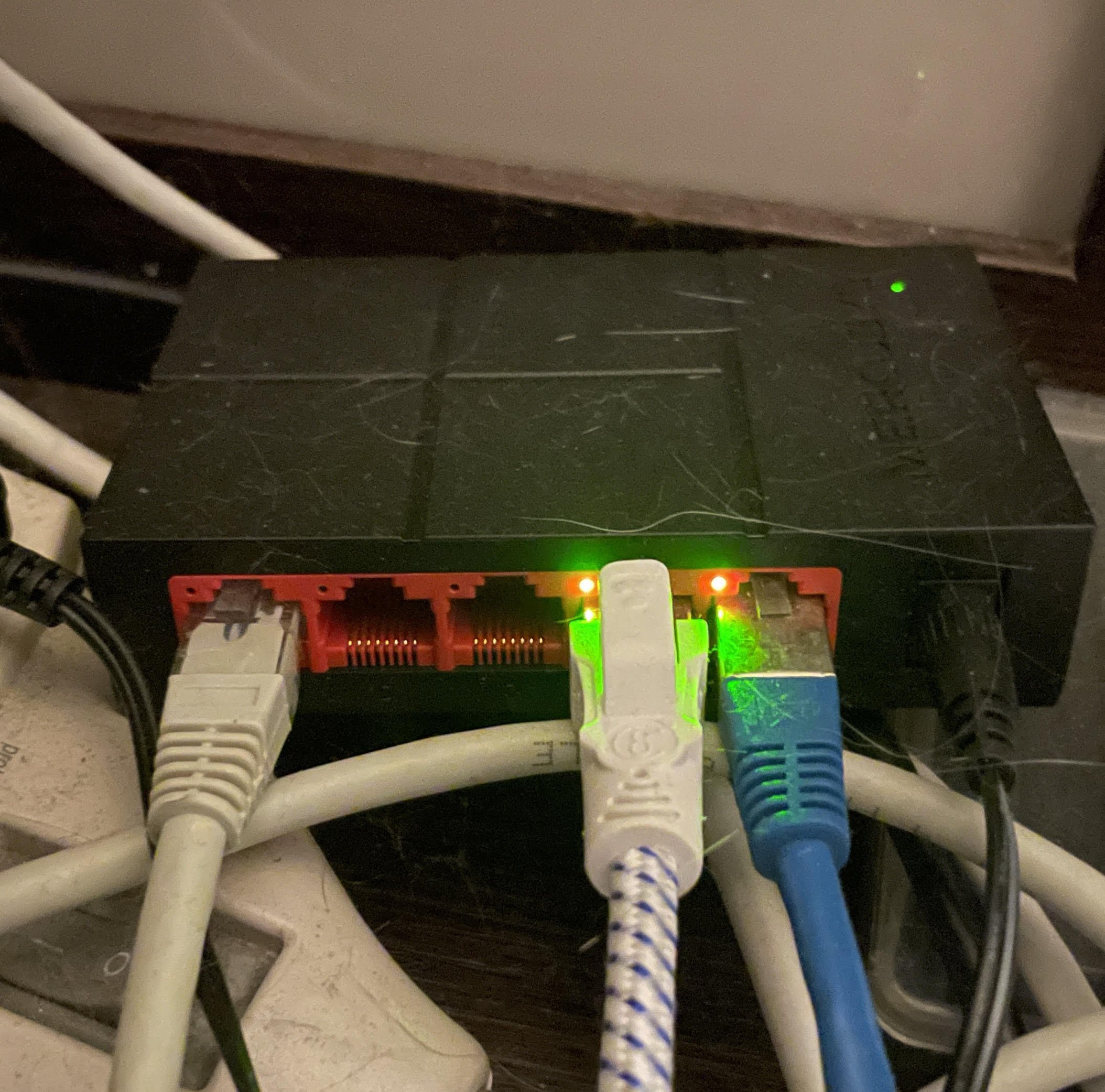

Just to try it out, I bought a 100/1000 switch. I attached the blue cable from ppoe of FW710 while the white next to it goes into my Fritzbox. (Ignore my cat's white hairs, it's impossible not to have them around)
When the problem occurs, the light on the blue cable, it just goes out, as if there was no signal from the FW710, as if it was switched off.
Then after a minute, it comes back on.
It happens infrequently, this month it has happened maybe twice, but it is still annoying, especially not knowing what it is or what I have to analyse to understand.

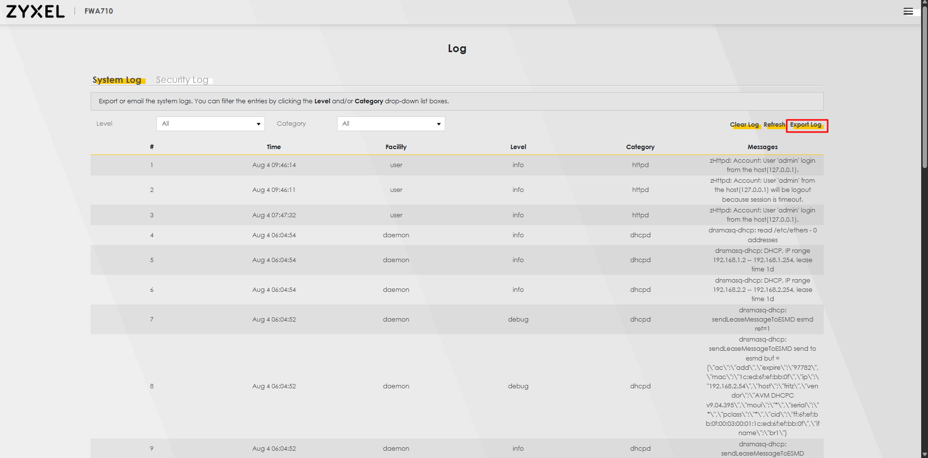

There is some kind of log that i can examine?

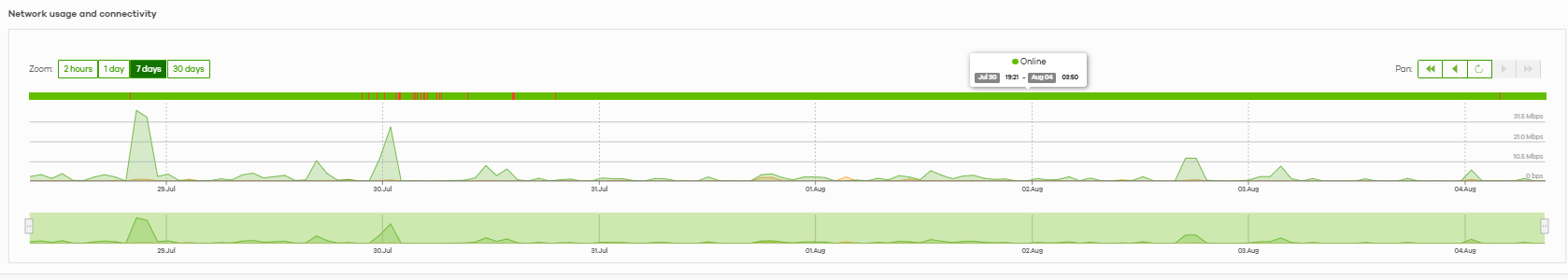

Hi @Luke77
Sorry for the delay. I checked your device's Nebula connectivity, and found it have abnormal IP change behavior. Could you enable Zyxel support access so we can access the device's local web GUI to check? Thanks!
