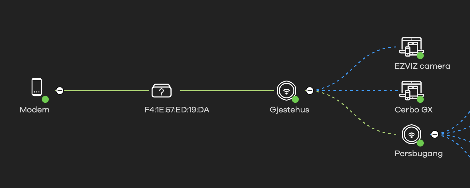

I have a FWA710 (modem in PIC) and two NWA55AXE (Gjestehus and Persbugang in PIC). I recently added a POE+ switch after the FWA710 and it shows up with MAC adsress in topology. My problem is that the Cerbo GX does not receive an IP address when connected to the Switch via Ethernet cable. It connects only via Wireless. I have tried connecting the Cerbo with Ethernet cable directly to the FWA710 and that works fine. I have set up the FWA710 with Cellular IP Passthrough - Disabled. What can I do to restore a cabled connection to my Cerbo GX - via the switch?

The switch currently in use is not managed and does not show up in topology, but there is a strange "double" connection from Router to AP. Anyway, still same issue with "Cerbo GX" not receiving IP-address from wired connection (the Cerbo GX states "receiving IP-address….."), it will only connect via wireless. I have probably missed something in settings. Can it be DHCP server settings?
