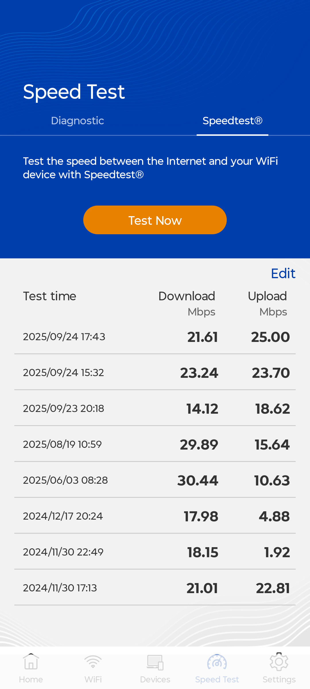

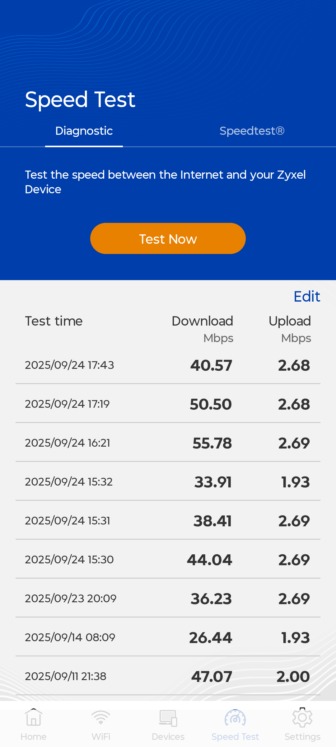

In case it helps, I've attached the screen showing the tests I have done recently. The fact that so many of the upload speeds seem to be capped at 2.69M suggests to me that these are not actually reporting the correct upload speed.
I've also attached the tests done using the Speedtest service, which shows upload speeds approximately ten times as fast.

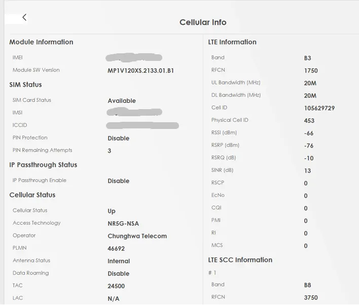

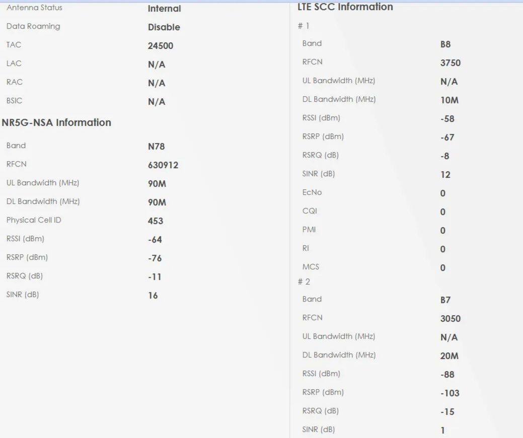

Based on the Cellular Info and the speedtest result you shared, we can see that the FWA510 is currently connected only to LTE Band 8, with both upload and download bandwidth to 10M. This explains why the speed is capped around that level.
In our tests, the device was able to aggregate multiple LTE bands(B3, B7, and B8), resulting in significantly higher throughput. Since your device is on B8 only, the performance is limited by the network conditions in your area. Therefore, we can confirm that this behavior is not related to a firmware fault.

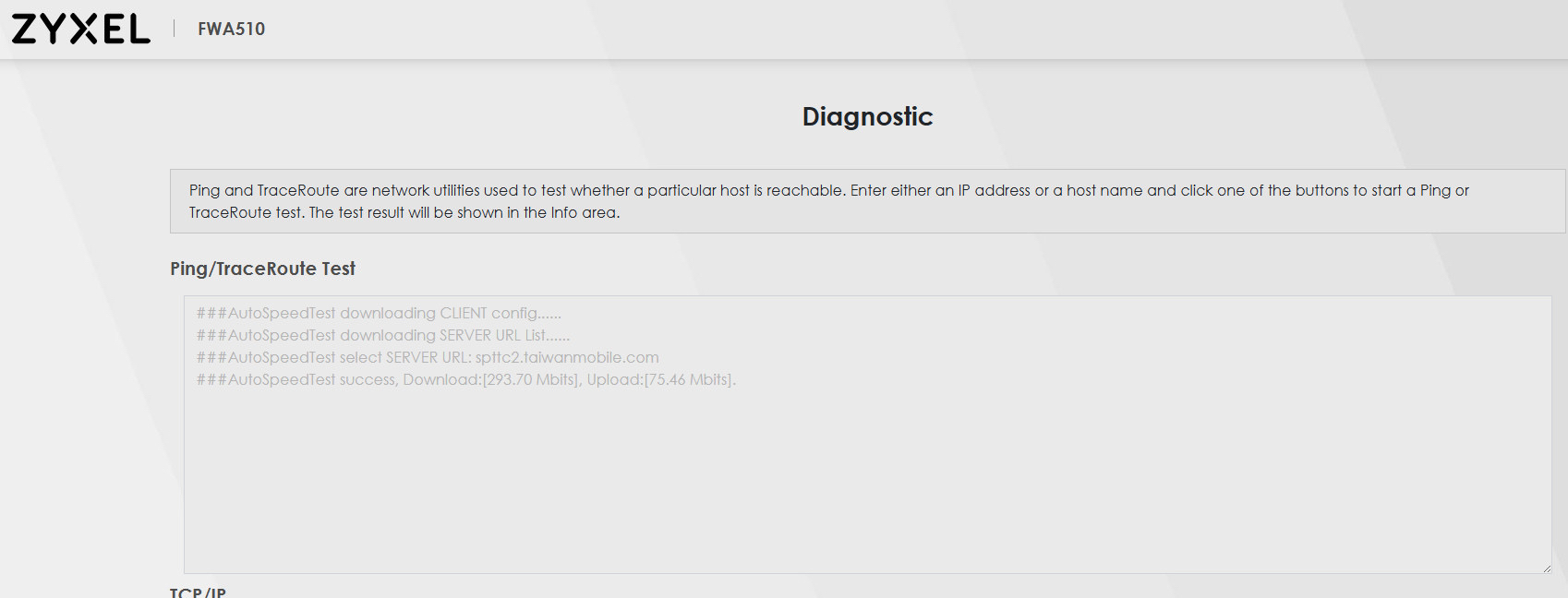

After confirming, the Speedtest® in the FWA510 first resolves the wireless client’s IP to geographic coordinates, then selects a nearby Ookla speed-test server from the server list to run the speed test. Although this is conceptually similar to the web Ookla test, the FWA510’s diagnostics implementation is different from the Ookla’s original source code. As a result, the actual behavior, such as the server chosen, timing, or parallel streams, and the testing method may vary the results .
To investigate further, could you please help us run the speed test again? We recommend placing the FWA510 where the signal is stronger (aim for an RSSI around –70 dBm or better), since the test can be affected by the current signal strength. This will show whether the low 2~3 Mbps is due to radio/bandwidth conditions or something else. If, after improving the signal, the Diagnostics test still reports around 2 Mbps, we will need to further analyze the issue to identify the root cause.
