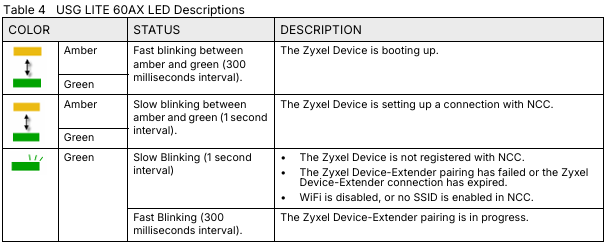

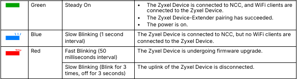

    4. When the issue occurs, what is the LED status on the device? Also, do you see any related error messages in the event logs?
      1. You may refer to the LED descriptions to identify the status image.png image.png
